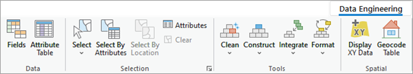

Data Engineering ribbon
When the Data Engineering view is active, a contextual ribbon appears at the top of the application. The ribbon provides access to commands and tools for exploring and preparing data.
The Data group on the ribbon provides access to the fields view and attribute table of the layer associated with the active Data Engineering view. The Tools group offers four tool galleries: Clean, Construct, Integrate, and Format. Each tool gallery contains a subset of geoprocessing tools for the respective data engineering task. By default, the layer associated with the active Data Engineering view is used to automatically populate the input features parameter of these tools. In the Spatial group, Display XY Data and Geocode Table convert your non-spatial stand-alone tables to spatial data.
