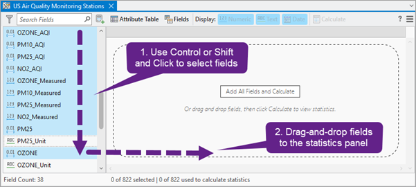

Select fields and calculate statistics
When you open the Data Engineering view, it contains two panels: one displays the fields in the data, and the other displays a statistics table for the fields (once they have been selected and calculated).
Learn more about the Data Engineering view
To get started, click a field in the fields panel, press Ctrl and click to select individual, separate fields, or press Shift and click to select multiple fields. Then drag the fields to the statistics panel.
Select and drag fields to the statistics panel
Alternatively, right-click the selected fields, and click Add To Statistics or Add To Statistics And Calculate.
Note:
You can also add and calculate all fields in one action by clicking the Add Fields and Calculate Statistics button on the toolbar of the Fields Panel or by clicking the Add All Fields and Calculate button in the middle of the empty statistics panel prior to adding fields.

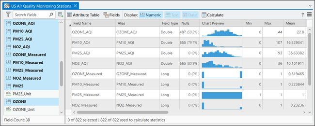

Once the fields are added, they are displayed as rows in the statistics table. Each row contains the field name, alias, and data type of the selected fields. Additionally, a series of statistics columns appear that will contain additional information about the selected fields once calculations are made.
To populate the statistics columns for the selected fields, click the Calculate button. While the statistics are being calculated, the Calculate button changes to a Cancel button that you can click to cancel the calculation.
Calculate button
The statistics columns are populated with information for each field of the data.
Statistics table with statistics and charts for each field
If you selected records, the results correspond to the selected records in the data. The number of selected features and the number of features that were used to calculate statistics are shown below the statistics table.
If you selected values in a raster layer with a raster attribute table, the number of selected rows and the number of cells that were used to calculate statistics are shown. The number of cells is based on the Count field in the raster attribute table.
If you have pending edits in the feature layer or table, the pending edits are used in the calculation.

Interactive statistics table
The statistics table is interactive. Right-click cells and headers and use the toolbar to access functionality.
Interact with fields
Right-click a row header to access functionality applicable to the selected field such as the following:
  • Create Chart—Create charts using the selected field. Recommendations are provided based on the data type.
  • Fields—Open the fields view and set the current field as the active field in the view.
  • Attribute Table—Open the attribute table and set the current field as the active field in the attribute table.
  • Clean, Construct, Integrate, and Format—Access geoprocessing tools to prepare the data. See Prepare data to learn more about these options.
  • Remove Field—Remove the field and clear its statistics from the statistics table.
Note:
Most geoprocessing operations that modify the input data cannot be undone.
Functionality options for a row in the statistics table
Interact with cells
Right-click a cell to access functionality applicable to the selected cell. You can use Copy to copy the cell's value to the clipboard. For cells in the Chart Preview column, you can open the default chart of the cell or create a chart applicable to the data type of the cell. For all other columns, context-sensitive selection and geoprocessing tool options are available. For example, the Standard Deviation column allows selection of records within one, two, or three standard deviations of the mean value and contains links to the Standardize Field and Transform Field tools. For a list of all applicable options and functions for each column, see the table in the Types of statistics section above.
Note:
Context-sensitive selection is disabled in the following cases:
  • The calculated statistics were performed on a selection. To make selections on calculated statistics from a selection on a layer, you can create a selection layer.
  • The field of a selected cell has data type float or double.
Display specific data types
The statistics table toolbar includes options to designate which fields and statistics columns are displayed based on data type.
Options on the statistics table toolbar
For example, you can click the Text button to remove fields of data type text. Click the Numeric button to hide and display fields with data type short, long, big integer, float, and double. Click the Date button to hide and display fields with data type date, date only, time only, and timestamp offset.
When you remove data types from the statistics table, the columns that are unique to the removed data type are also removed. This can make it easier to review the table for items of interest. For example, if you display only fields of type date, columns that describe distributions, such as skewness and kurtosis, are omitted, so the number of columns is reduced to only those of interest.
Sort, hide, freeze, and reorder columns
By default, the fields display in the order that they appear in the attribute table. The options for the column headers allow you to sort, hide, and freeze the columns in the table.
Options for the Number of Nulls column in the statistics table
Sorting allows you to reorder the rows by the value in the calculated statistic. For example, you can sort fields by the Nulls column to learn which fields may have missing data.
Note:
You can only sort if the table contains fields with a single data type. Use the display options on the toolbar to filter to a specific data type; then sort. The sort order is reset to the default each time a new field is added to the statistics table.
Click Freeze/Unfreeze to move the column to the beginning of the statistics table and lock it in place so that the column displays as you scroll the table horizontally. To reorder the columns, drag a column header to the new location.
To hide columns, click Hide Column. This removes the column from view. To show all hidden columns, click Show All Columns.
Show All Columns option
To remove all the fields and their statistics from the statistics table, click Remove All Fields. If a removed field is added back to the statistics table, you will need to click the Calculate button again to view its statistics.
