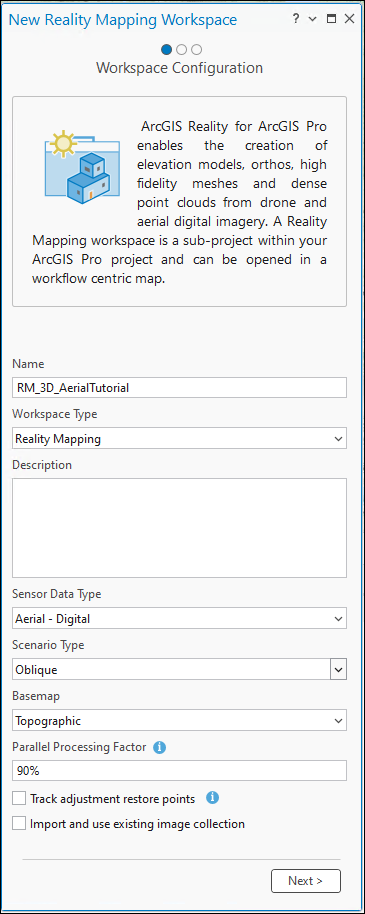

On the Imagery tab, in the Reality Mapping group, click the New Workspace drop-down menu and choose New Workspace.
In the Workspace Configuration window, provide a name for the workspace.
Set Workspace Type to Reality Mapping.
In the Sensor Data Type drop-down menu, choose Aerial - Digital.
Set Scenario Type to Oblique.
This setting is recommended when working with a combination of oblique and nadir imagery.
In the Basemap drop-down menu, choose Topographic.
Set the Parallel Processing Factor value of the workspace to 90%.
Setting the Parallel Processing Factor value to 90% means that 90% of total CPU cores will be used to support Reality mapping processing. The Parallel Processing Factor value can also be changed in Properties in the Workspace group in the Imagery tab after the workspace is created.
Setting the Parallel Processing Factor value higher than what your system can accommodate will lead to parallel processing failures. A common requirement is that for each logical processor, you need 2GB of RAM. For example, if you are working with a system that has 6 cores, 12 logical processors, and 16 GB RAM, setting the parallel processing factor to 100 percent would require a minimum 24 GB of RAM for the process to run successfully. A more appropriate Parallel Processing Factor value based on this example would be 50 percent. which would require approximately 12 GB of RAM.
Accept all the other default values and click Next.

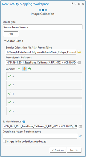

In the Image Collection window, under Exterior Orientation File / Esri Frames Table, browse to the tutorial data folder on your computer and the
Nadir_Oblique_FramesCam.csvframes table file.This table, which contains the frames and cameras information, specifies parameters that are used to compute both the IO and EO for the camera and the imagery. In the block adjustment process, these approximate values are refined for greater accuracy.
Ensure that the data paths listed in the
rastercolumn in the frame table file match the location of the image files on your computer.Under Cameras, click the Import button
, browse to the tutorial data folder on your computer, and select the Nadir_Oblique_FramesCam.csvfile.For this tutorial, the Esri frame and camera tables are provided as a single file in the proper format. For other data sets, you may need to build and format the tables. For more information, see Frames table schema.
Ensure that the Spatial Reference and camera model values are correct.
The default projection for the workspace is defined based on the imagery. This projection must match the coordinates used in the frames table, and it determines the spatial reference for the Reality products you create. For this dataset, you’ll use the projection defined in the frames and cameras table: XY – NAD83 2011 StatePlane California V FIPS 0405, VCS NAVD88 (meters).
Accept the other default values and click Next.

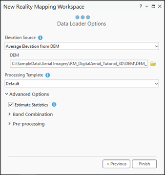

In the Data Loader Options window, under DEM, click the browse button, browse to the tutorial data folder on your computer, and select the
DEM_USGS_1m.tiffile.Accept the other default values and click Finish.

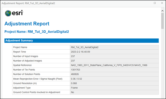

After the adjustment is complete, turn on the Tie Points layer in the Contents pane to view the distribution of generated tie points on the map.
You can view the tie point residuals and accuracy reporting in the logs file.
On the Reality Mapping tab, in the Review group, click Logs View
to access this file.
The units for tie point RSME is pixels.
Review the adjustment results
After performing a block adjustment, review the adjustment results and assess the quality of the adjustment. On the Reality Mapping tab, in the Review group, click Adjustment Report to generate adjustment statistics. The adjustment report provides a record of the adjustment and overall quality measures of the process.

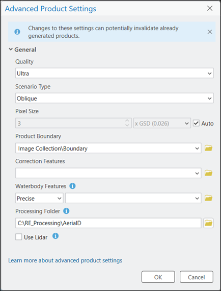

Click the Shared Advanced Settings button.
The Advanced Products Settings dialog box appears, where you can define parameters that will impact the Reality mapping products to be generated. For details of the advanced product settings, see Shared Advanced Settings option.
Ensure that Quality is set to Ultra.
Ensure that Scenario is set to Oblique to match the image flight configuration.
During initial product generation, the Reality mapping process creates files based on initial product settings. Changing the Quality value after initial product generation adversely impacts processing time and initiates regeneration of previously created files and products.
Accept the Pixel Size default settings to generate products at source image resolution.
For Product Boundary, click the Browse button
, browse to the tutorial data location, select Mesh_bdryfeature data, and click OK.It is recommended that you provide a product boundary for the following reasons:
Define the proper output extent—When you do not define a product boundary, the application automatically defines an extent based on various dataset parameters that may not match the project extent.
Reduce processing time—If the required product extent is smaller than the image collection extent, defining a product boundary reduces the processing duration and automatically clips the output to the boundary extent.
For Processing Folder, click the Browse button, navigate to a location on disk that has a minimum available storage of 10 times the total size of the images being processed. In this case, 50 GB or more available storage is recommended.
Accept all the other default values and click OK.
The Advanced Products Settings dialog box closes, and you return to the Product Generation Settings pane in the Reality Mapping Products wizard.

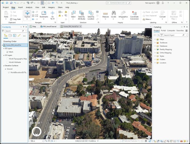

Once product generation is complete, the point cloud and 3D mesh products are added to the Reality Mapping container in the Point Cloud and Meshes folders, respectively. A LAS dataset is added to the Contents pane to manage the point cloud.
To visualize the generated 3D mesh, right-click the
3D_Mesh.slpkfile in the Meshes folder, and click Add to New > Local Scene in the drop-down menu.To visualize and activate the generated point cloud, click the LAS dataset in the Contents pane to view it in the 2D map.
To visualize the generated point cloud in a 3D perspective, right-click the LAS dataset in the Contents pane and add it to a local scene or a global scene.
