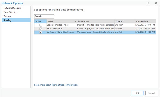

Share named trace configurations
Beginning with ArcGIS Enterprise 10.9, named trace configurations that are added to a trace network in an enterprise deployment can be shared through a web map and consumed by web and field apps. To be included in the map definition of a web map, a named trace configuration must first be set as active for sharing.
The Sharing pane on the Network Options dialog box is used to set named trace configurations as active for sharing. To access the Sharing tab, click the dialog box launcher on the Trace Network tab, to the lower right of the Tools group, and click the Sharing tab.
The Sharing tab lists all of the named trace configurations for the trace network in the current map.
Sharing tab of the Network Options dialog box
Optionally, check the Active check box next to a named trace configuration on the dialog box. This activates a named trace configuration for sharing and includes it in the web map's map definition. Uncheck the option to deactivate a trace configuration from sharing. This option is unchecked by default when new named trace configurations are added to the trace network.
Learn more about how to share a web map
