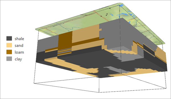

Illustration
Nearest Neighbor 3D tool illustration
A voxel layer displays the soil and rock classes of the closest 3D point.
