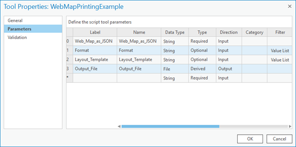

The following screen capture shows a sample script tool's parameters:
Sample script tool parameters

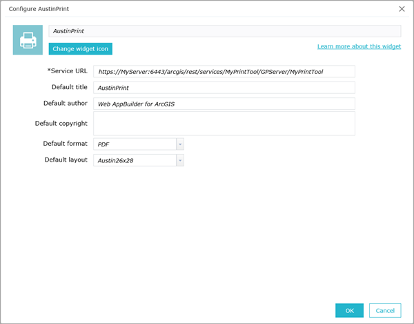

After sharing the Python script tool as a web tool, the Print widget in ArcGIS Web AppBuilder is configured to use the REST URL of the web tool. The following screen capture shows the configuration dialog box for the Print widget:
The configuration dialog box for the Print widget
ヒント:
In the screen capture above, the values for Default format and Default layout are automatically populated from the Format and Layout_Template parameters from the web tool.
