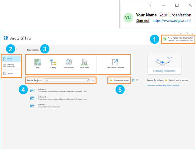

    Once you sign in, the ArcGIS Pro start page appears. It appears immediately if you sign in automatically.
    ArcGIS Pro start page with numbered callouts
Element Description
1 Your profile name and ArcGIS organization appear at the top of the ArcGIS Pro window.
2 You create and open projects on the Home tab of the start page. Tutorials and other help are available on the Learning Resources tab . On the Settings tab , you can set options for ArcGIS Pro and access application-wide functionality.
3 Start a new project. Four templates are provided; each opens the new project in a different state. You can open a blank project by starting without a template.
4 Open a project from the list of recent projects.
5 Browse to or search for a project that is not in the recent projects list.
ArcGIS Pro start page elements on the Home tab

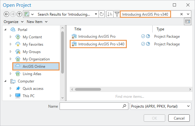

  2. On the Open Project browse dialog box, in the navigation pane, under Portal , click ArcGIS Online .
    Note:
    If you are signed in to ArcGIS Enterprise , you must set your active portal to ArcGIS Online to access the tutorial data. If you can't do this, you can download the data from a browser.
  3. In the search box at the top of the dialog box, type Introducing ArcGIS Pro v340 and press the Enter key.
    Open Project dialog box showing search term and search results
    Your search results may be different, but the Introducing ArcGIS Pro v340 project package should be present.
  4. In the list of search results, click Introducing ArcGIS Pro v340 to select the project package.

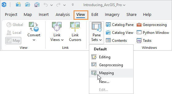

  6. On the ribbon, click the View tab. In the Windows group, click Pane Sets and click Mapping .
    View tab location on the ribbon
    This ensures that the Contents and Catalog panes are open and that all other panes are closed.

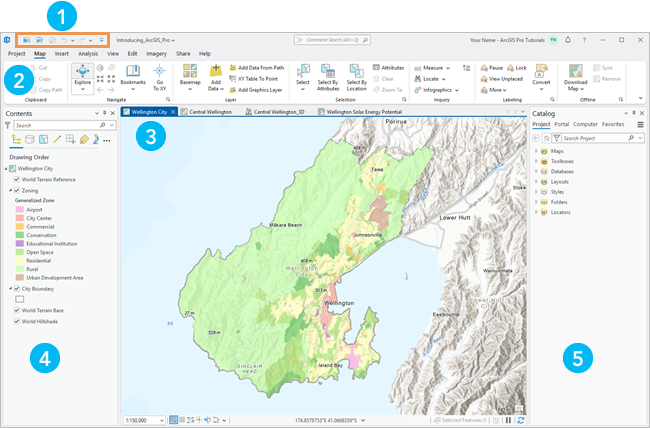

    The Contents pane displays the map contents. The map is named Wellington City and contains several layers of data, such as Zoning and City Boundary.
    Project with numbered callouts
    Element Description
    1 The Quick Access Toolbar has common commands. For example, you can save the project or undo an action.
    2 The ribbon consists of a series of tabs. Each tab, such as the Map tab, has its own set of commands.
    3 A view can display a map, a layout, a table, a chart, or another item.
    4 The Contents pane shows the contents of the active view, such as the layers in a map or the layout elements in a layout.
    5 The Catalog pane provides access to data and other items used in the project, such as databases, toolboxes, and folder connections.
    Common elements of the user interface of a project

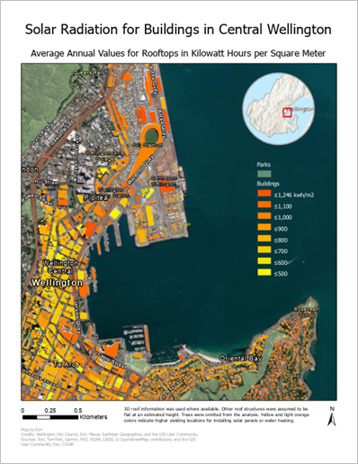

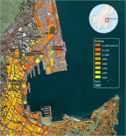

    The map shows buildings in the city center symbolized by their solar energy potential. Dark orange buildings receive the most sunlight and yellow buildings receive the least.

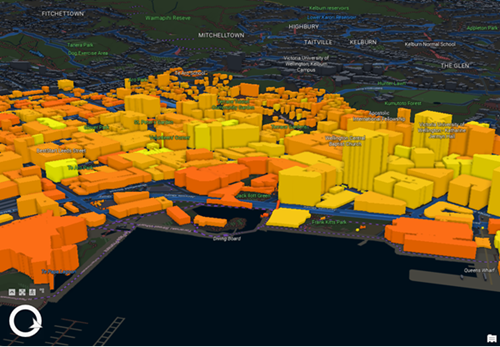

  2. Click the view tab of the Central Wellington_3D local scene to make it active.
    Central Wellington_3D is a local scene that shows the buildings in 3D. A scene in ArcGIS Pro can be local or global.

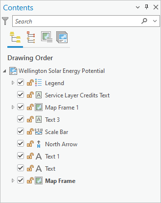

  3. Click the view tab of the Wellington Solar Energy Potential layout.

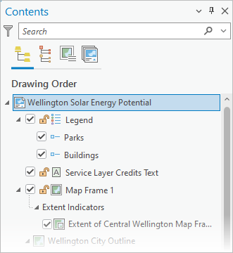

    The layout is based on the Central Wellington map. When a layout view is active, the Contents pane displays the layout page elements, such as map frames, legends, scale bars, and text.

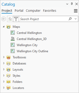

  6. In the Catalog pane, expand the Maps container .
    Contents pane with Maps container expanded
    The project contains three maps and a local scene. The Wellington City Outline map, which is used for the inset map in the layout, is not open.
  7. Right-click the Wellington City map and click Open .
    The map reopens and becomes the active view. Its view tab is positioned next to the Wellington Solar Energy Potential view.

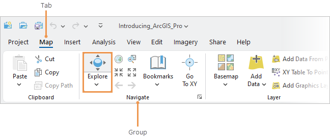

  8. On the ribbon, click the Map tab.
Explore the map
The ribbon has a set of core tabs that are either always present or always present when a certain type of view is active. For example, the Map tab is present whenever a map is the active view.
Each tab has its own tools, organized in groups. The Map tab has tools for interacting with the map. On the Map tab, in the Navigate group, the Explore tool is selected by default.
ArcGIS Pro ribbon
A gray highlight on the Explore tool indicates that it is selected.
The Explore tool is a split tool. Clicking the top half performs an action (getting information about map features). Clicking the bottom half opens a drop-down list of choices that adjust the tool's behavior. When the Explore tool is selected, you can navigate the map by panning and zooming.

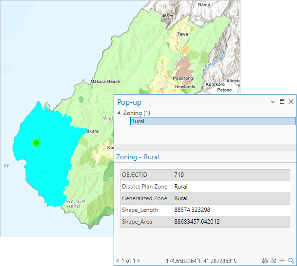

  8. On the map, click anywhere inside the city boundary.
    Pop-up with zoning information about Wellington
    A feature in the Zoning layer flashes on the map. The Pop-up pane appears with the feature's zoning designation.
  9. Click some other features in the Zoning layer to see their pop-ups.
  10. At the top of the Pop-up pane, click Close to close the pane.

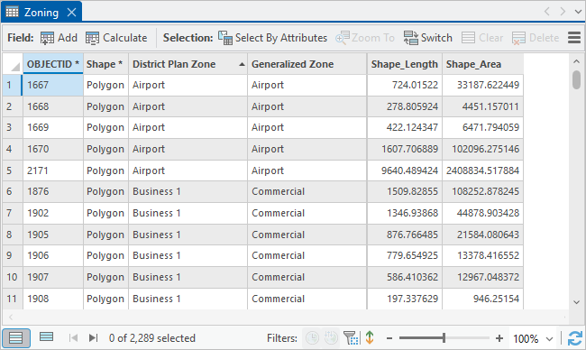

  2. On the ribbon, click the Data tab. In the Table group, click Attribute Table .
    Zoning layer attribute table
    The layer's attribute table opens in a view. Each row in the table corresponds to a feature in the layer. Each column is an attribute, or category of information. For example, the table has two zoning attributes: District Plan Zone and Generalized Zone.
    By default, the table view is docked below the map. It may partially block your view of the map.
    Tip:
    The default docking position of some views can be changed in the user interface options.
  3. Drag the table view by its view tab away from its docked position.
    As you drag the view over the application window, its position is represented by a semitransparent blue rectangle. If you hover over the map, docking targets appear.
    Docking targets
  4. Drag the table view to a location that is not on a docking target and release the mouse button.
    The view now floats over the application window.
  5. If necessary, drag the view to a location that does not block your view of the map. Optionally, resize the view by dragging its sides or corners.
    Tip:
    You can minimize a floating view by clicking the Minimize button at the top of the view. A minimized view is open but not visible on the screen. To restore a minimized view, hover over the ArcGIS Pro icon in the Windows taskbar and click the view.

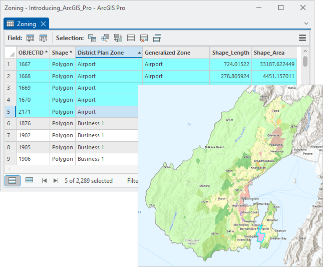

  6. In the table, click the gray square numbered 1 at the edge of the table to select the first row.
    The row is highlighted in the table and its corresponding feature—part of Wellington International Airport—is selected and highlighted on the map in the southeastern part of the city.
  7. Hold the Shift key. In the table, click the gray square numbered 5.
    Attribute table with selected records and map with corresponding selected features
    Five records are selected in the table—all those with the zoning designation of Airport. The corresponding map features are also selected.

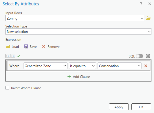

    Suppose you want to see all the areas that have a certain zoning designation, such as Conservation. You could scroll through the table and select them manually, but there is a better way.
  8. On the ribbon, click the Map tab. In the Selection group, click Select By Attributes .
    The Select By Attributes window appears. You'll create a query to select the features you want to see on the map.
  9. In the Select By Attributes window, confirm that the Input Rows parameter is set to Zoning and the Selection Type parameter is set to New selection.
  10. In the expression builder, click the Where drop-down arrow and click Generalized Zone.
    Additional boxes appear in the expression builder.
  11. Confirm that the logical operation is set to is equal to. To complete the expression, click the empty drop-down list of generalized zone values and click Conservation.
    Select By Attributes window with completed expression
  12. Click OK.
    At the bottom of the table view, you can see that 48 of 2,289 records are selected. The corresponding features are selected on the map.

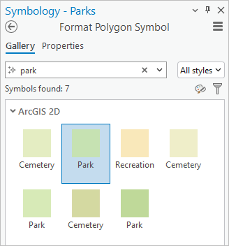

  6. In the Symbology pane, click the green symbol.
    The pane presents options for formatting polygon symbols. At the top of the pane are a Gallery tab and a Properties tab. On the Gallery tab, you can choose a predefined symbol from the styles, such as ArcGIS 2D, that are added to the project. On the Properties tab, you can modify symbol properties, such as color and outline width.
  7. Click the Gallery tab if necessary.
  8. In the search box, type park and press the Enter key.
    In the ArcGIS 2D style, several park and cemetery symbols are found. You can hover over the symbols to get more information about them.
  9. Click any park symbol to select it.
    Park symbol selected in the symbol gallery
    The symbol updates in the Contents pane and on the map.

  1. Click the view tab of the Central Wellington_3D scene to make the scene active.
  2. On the ribbon, on the Map tab, in the Navigate group, click Bookmarks . Under Central Wellington_3D Bookmarks, click Jervois Quay.
    3D view of buildings in central Wellington
  3. Click Bookmarks again and click View from Lambton Harbour to view the scene from another perspective.

  1. Click the view tab of the Wellington Solar Energy Potential layout to make the layout active.
    Map layout
    A layout includes one or more map frames, representing maps or scenes in your project; map surrounds, such as legends, scale bars, and north arrows; text; and sometimes pictures or graphic elements.
    This layout has two map frames. The main map is the Central Wellington map and the circular inset map is the Wellington City Outline map. (Earlier in the tutorial you saw this map in the list of maps in the Catalog pane, but you did not open it.) Note that the Central Wellington map in the layout displays the imagery basemap you applied to the map view.

    The Contents pane lists the layout elements: the map frames, the legend, the text elements, and so on.
    Contents pane for layout view
    By default, the elements are listed in their top-to-bottom drawing order. You can use the graphic tabs at the top of the Contents pane to organize them in different ways.
  2. In the Contents pane, click List By Element Type.
    The layout elements are now grouped by type. This may help you find an element you want to work with.
  3. Click List By Map Frame and expand the two map frames.
    In this grouping, you see the layers in each map and the map surrounds associated with each map frame. In this layout, the legend, north arrow, and scale bar are all associated with the map frame that contains the Central Wellington map.
  4. Click List By Drawing Order to return to the default grouping.
    Contents pane with Legend element expanded
    You'll add a border to the legend to help it stand out on the layout.
  5. In the Contents pane, right-click Legend and click Properties .
    The Element pane appears with properties and settings for the legend.
  6. At the top of the pane, on the Legend tab, click the drop-down arrow and click Border.
  7. On the Symbol tab , under Appearance, click the Color drop-down arrow and click Gray 40%.
    Color palette with Gray 40% indicated (row 5, column 1)
  8. Increase the line width to 2 pt. At the bottom of the pane, click Apply.
  9. At the top of the pane, click the Layers tab . Expand Offset effect and increase the offset to 5 pt. Click Apply.
    Notice that the symbol for parks is listed above the symbols for buildings. Since the layout's purpose is to convey information about the solar potential of the buildings, it would be better if the building symbols appeared first.
  10. In the Contents pane, expand the Legend element if necessary, and drag the Buildings legend item above Parks.
    As you drag, the position of the legend item is represented by a thin horizontal line. When you release the mouse button, the legend is updated on the layout.
  11. In the Contents pane, click Wellington Solar Energy Potential at the top of the drawing order to deselect the legend element.
    Layout showing the modified legend
