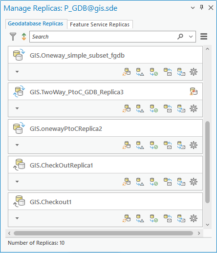

You can view and manage geodatabase and feature service replicas using the Manage Replicas pane in ArcGIS Pro. The Manage Replicas pane displays all replicas in an enterprise geodatabase and replicas that a specific feature class or table participates in along with the replica properties.
The method used to create a replica determines the type of replica it is—a geodatabase replica or a feature service replica. The Manage Replicas pane contains a tab for each type of replica.
Geodatabase Replicas—Geodatabase replicas are explicitly created using the Create Replica or Create Replica From Server geoprocessing tools. See Manage geodatabase replicas for an explanation of the tools and options available on this tab.
Feature Service Replicas—Feature service replicas are created when you take a feature service offline. See Manage feature service replicas for an explanation of the tools and options available on this tab.
