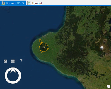

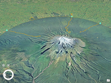

    The project opens to the Taranaki region on New Zealand's North Island. The boundary of Egmont National Park is drawn with an orange outline. Mount Taranaki, an inactive volcano, is in the center of the park.
    The active view is a local 3D scene named Egmont 3D. There is also a 2D map named Egmont.
    Imagery map of Taranaki region in New Zealand

  8. Click the Map tab. In the Navigate group, click Bookmarks . Under Egmont 3D Bookmarks, click View from above to zoom to the park boundary.
  9. Explore the scene with 3D navigation techniques and bookmarks.
    With the Explore tool selected on the Map tab, you can navigate with the mouse. You can also use the on-screen navigator in Full Control mode.
    Tip:
    If you're not familiar with 3D navigation, see the help topics Navigation in 3D and Use the on-screen navigator or complete the Navigate maps and scenes tutorial.
  10. When you're finished, return to the View from above bookmark.

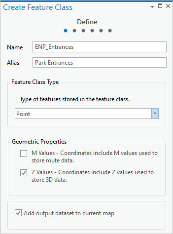

  3. On the Define page, for Name, type ENP_Entrances. For Alias, type Park Entrances.
    In the feature class name, ENP stands for Egmont National Park. The alias is a user-friendly name that is given to map layers based on the feature class.
  4. For Feature Class Type, click the drop-down arrow and click Point.
    Under Geometric Properties, the Z Values check box is checked by default. Point features added to this feature class will have z-values specifying their vertical position as well as x,y values specifying their horizontal position.
    The Define page of the Create Feature Class pane

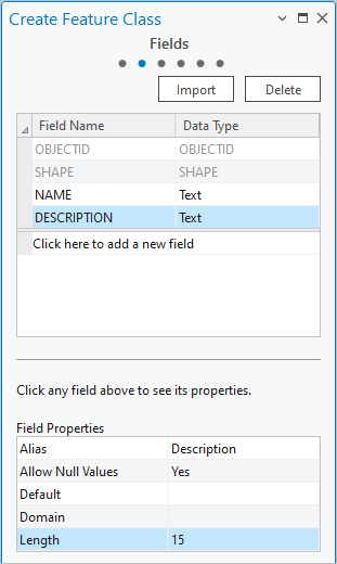

  11. Add another new field with the following properties:
    • Field Name: DESCRIPTION
    • Data Type: Text
    • Alias: Description
    • Length: 15
    The Fields page of the Create Feature Class pane

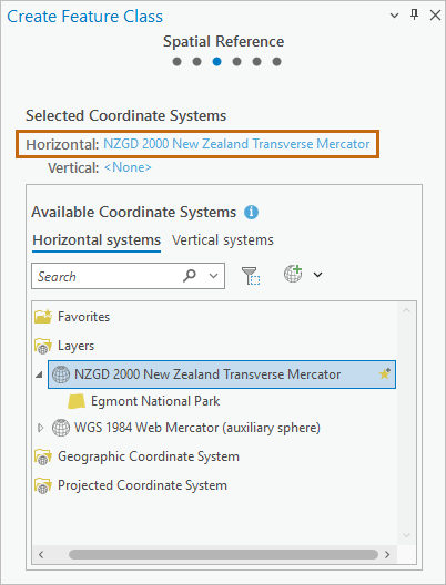

    On the Spatial Reference page, you'll select a coordinate system. You'll use the New Zealand Transverse Mercator, a common standard in New Zealand. Because this coordinate system is used by the Egmont 3D scene, it is selected as the horizontal coordinate system.
    The Spatial Reference page of the Create Feature Class pane
    Note:
    If you see a different selected horizontal coordinate system, click NZGD 2000 New Zealand Transverse Mercator under Layers to select it.

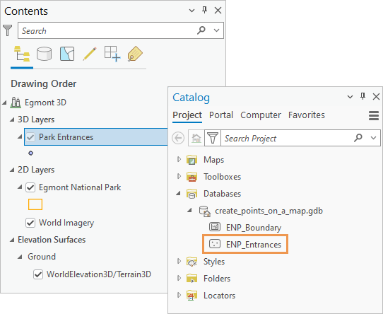

    In the Catalog pane, the ENP_Entrances feature class is added to the default geodatabase. In the Contents pane, a layer based on the new feature class is added to the map with the following properties:
    • Its name reflects the alias you assigned to the feature class.
    • It appears under the 3D Layers heading because you created the feature class with z-values.
    • Its visibility check box is dimmed because it doesn't have any features yet.
    Contents pane showing a new layer and Catalog pane showing the new geodatabase feature class.

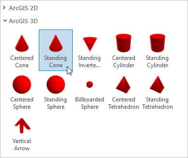

  3. Under Format Point Symbol, click the Gallery tab, if necessary.
  4. Next to the search box, click the All styles drop-down arrow and click Project styles.
    The Project styles setting includes the styles ArcGIS Pro adds to the project by default, as well as any other styles you add. The All styles setting includes all system styles installed with ArcGIS Pro. Choosing Project styles narrows the scope of symbol searches.
  5. In the search box, type cone and press the Enter key.
  6. If necessary, collapse the ArcGIS 2D style.
  7. In the list of available symbols, under ArcGIS 3D, click Standing Cone.
    Standing Cone symbol selected in the symbol gallery.

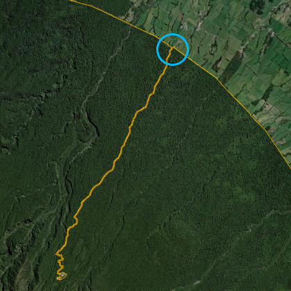

There are three road-based entries to the park. First, you'll create a point feature to represent the Egmont Road entrance.
  1. Confirm that the Egmont 3D scene is the active view. Hover over the scene.
    The pointer changes to a crosshairs with a symbol attached to it. If you click in the scene, you'll create a point feature wherever you click.
    Tip:
    If you add a feature in the wrong place, click Undo on the Quick Access Toolbar.

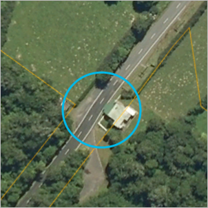

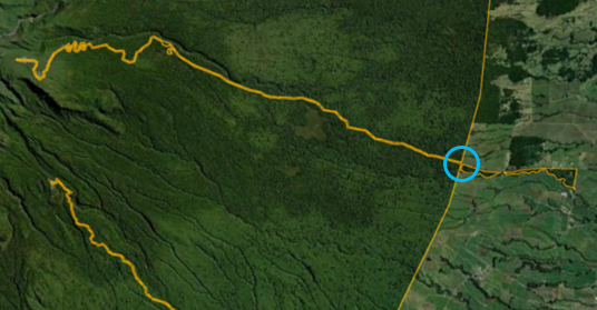

  2. On the ribbon, click the Map tab and click Bookmarks . Under Egmont Bookmarks, click Egmont Road.
    The map zooms in to the road.
    Map showing Egmont Road with park entrance circled
    The park entrance, circled in blue, is located at the intersection of the road and the park perimeter.

  4. Navigate to the area where the road enters the park. To pan the map, click and drag the left mouse button while holding the C key. To zoom in and out, use the wheel button or hold the right mouse button and drag.
    Zoomed-in view of park entrance
    The park entrance is where the cleared land ends and the forest begins.

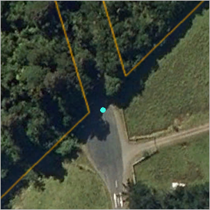

  5. Release the C key, if necessary. Click the road at the entrance to the park.
    Feature placed on Egmont Road
    The feature is added to the map and is selected. You'll add an attribute value for the name of this entrance.

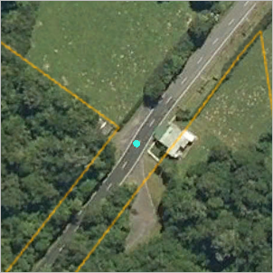

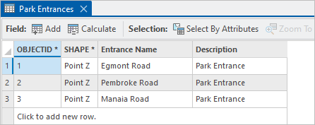

  1. On the Map tab, click Bookmarks . Under Egmont Bookmarks, click Pembroke Road.
    Map showing Pembroke Road with park entrance circled
  2. Navigate to the area where the road enters the park.
  3. Click to add a point on the road.
    Feature placed on Pembroke Road.
  4. In the Attributes pane, for Entrance Name, type Pembroke Road. Press the Enter key and click Apply.

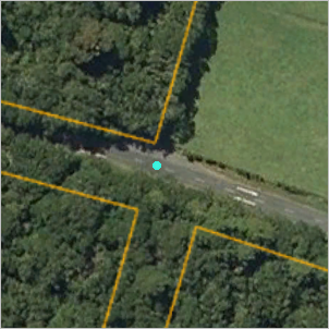

  5. Go to the Manaia Road bookmark.
  6. Navigate to the park entrance and add a point.
    Feature placed on Manaia Road.
  7. In the Attributes pane, for Entrance Name, type Manaia Road. Press the Enter key and click Apply.
  8. On the editing toolbar that appears near the bottom of the scene, click Finish .

  12. In the Contents pane, right-click the Park Entrances layer and click Attribute Table .
    Park Entrances attribute table
    The table has three records with the attribute values you provided. The values in the Shape field are Point Z because the features have z-values.
  13. Close the table.
  14. Click the Map tab and click Bookmarks . Under Egmont 3D Bookmarks, click View from above.
  15. On the Map tab, in the Navigate group, click Explore .
  16. Navigate the scene and examine the park entrances from different perspectives.
    A view of the three park entrances looking east

Any layer can be displayed in either a 2D map or a 3D scene, regardless of whether the layer has z-values. You'll copy the Park Entrances layer from the 3D Egmont scene into the 2D Egmont map.
  1. In the Contents pane, under 3D Layers, right-click Park Entrances and click Copy .
  2. Make the Egmont map view active.
  3. In the Contents pane, right-click the Egmont map name and click Paste .
    The Park Entrances layer appears at the top of the layers in the Contents pane and the features appear on the map.
  4. On the ribbon, click the Map tab and click Bookmarks . Under Egmont Bookmarks, click Egmont National Park.
  5. Optionally, in the Contents pane, click the Park Entrances symbol. In the Symbology pane, click the Gallery tab and choose a different symbol.
  6. On the Quick Access Toolbar, click Save Project .

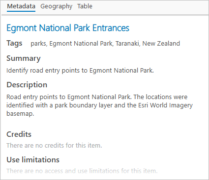

  2. In the metadata view, in the Title box, type Egmont National Park Entrances.
  3. In the Tags box, type (or copy and paste) the following keywords: parks, Egmont National Park, Taranaki, New Zealand.
    Make sure the keywords are separated by commas.
  4. In the Summary (Purpose) box, add the following text: Identify road entry points to Egmont National Park.
  5. Click in the Description (Abstract) box.
    In the Contents pane, the Item Description metadata editor page is now marked valid because all required information (title, tags, and summary) is present.
    Note:
    If spell-checking is enabled in the Proofing options (as it is by default), unrecognized words are marked with wavy underlines.
  6. In the Description (Abstract) box, add the following text: Road entry points to Egmont National Park. The locations were identified with a park boundary layer and the Esri World Imagery basemap.
  7. On the ribbon, on the Metadata tab, in the Manage Metadata group, click Save .
  8. Close the ENP_Entrances metadata view.
  9. In the Catalog pane, right-click the ENP_Entrances feature class and click View Metadata .
    A catalog view opens. In the details panel, the Metadata tab displays the metadata you added.
    Details panel of a catalog view showing item metadata
  10. On the Quick Access Toolbar, click Save Project .
