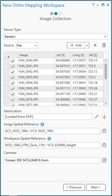

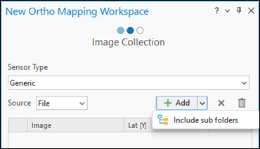

  12. In the Image Collection window, click the Sensor Type drop-down menu, and choose Generic.
    This option is used because the imagery was collected with an RGB camera.
  13. For Source, ensure File is selected from the drop-down list.
  14. Click Add, browse to the tutorial data location, and select the Images folder. If the images are stored in sub-folders, click the drop-down menu next to Add and select Include sub folders.
  15. Click Add Images, browse to the tutorial data location, select the Images folder, then click OK. If the images are stored in sub-folders, click Add Images (Includes sub folders).
    Ortho Mapping Workspace Image Collection
    Note:
    Most modern drones store GPS information in the EXIF header. This will be used to automatically populate the table shown below. However, some older systems or custom-built drones may store GPS data in an external file. In this case, you can use the Import button Import next to the Geolocation parameter to import external GPS files.
  16. The Image Spatial Reference is automatically populated with information from the image EXIF header.
  17. Ensure the Workspace Spatial Reference and Camera Model are correct.
    Note:
    The default projection for the workspace is based on the latitude, longitude, and altitude of the images. This projection determines the spatial reference for your ortho products, including the orthomosaic and DEM. For this dataset, you’ll use the default projection.

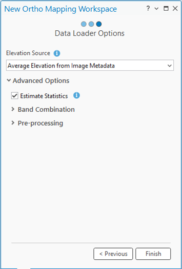

    The Data Loader pane will open.
  19. Accept all default setting in the Data Loader window and click Finish.
    Ortho Mapping Workspace Data Loader

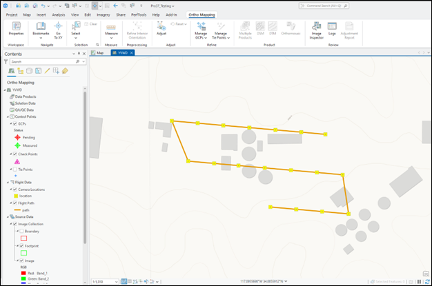

    Once the workspace has been created, the images, drone path, and image footprints are displayed. An Ortho Mapping container is added to the Contents pane, where the source imagery data and derived Ortho mapping products will be stored.
    Ortho mapping workspace in Contents pane with flight path and image centers displayed in the map
    The initial display of imagery in the workspace confirms that all images and necessary metadata were provided to initiate the workspace. The images have not been aligned or adjusted, so the mosaic will not look correct.

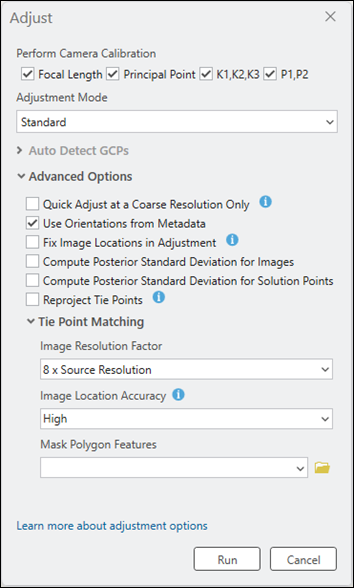

  1. On the Ortho Mapping tab, in the Adjust group, click Adjust Adjust.
  2. In the Adjust window, make sure Perform Camera Calibration options are all checked on.
    This indicates that the input focal length is approximate and that the lens distortion parameters should be calculated during adjustment. For drone imagery, this parameter is checked by default, as most drone cameras have not been calibrated. This option should not be checked for high-quality cameras with known calibration.
    The camera self-calibration requires that your image collection has in-strip overlap of more than 60 percent and cross-strip overlap of more than 30 percent.
  3. Ensure the Adjustment Mode is set to Standard.
    Auto Detect GCPs will not be used in this tutorial
  4. Expand the Advanced Options section.
  5. Ensure Quick adjust at coarse resolution only is unchecked.
    If this option is checked, an approximate adjustment will be performed at a coarse, specified resolution. If this option is not checked, tie points are first computed at a coarse resolution, followed by a refined adjustment at image source resolution. A one-step adjustment is appropriate for the sample data in this tutorial since the sample dataset is small, and the adjustment will be performed quickly.
  6. Check Use Orientations from Metadata.
    This reduces the adjustment duration by using the exterior orientation information embedded in the image EXIF as initial values.
  7. Ensure Fix image location in Adjustment is unchecked.
    This option is used only for imagery acquired with differential GPS, such as Real Time Kinematic (RTK) or Post Processing Kinematic (PPK) GPS.
  8. Uncheck the Compute Posterior Standard Deviation for Images check box.
  9. Expand the Tie Point Matching section.
  10. For the Image Resolution Factor drop-down menu, choose 8 x Source Resolution.
    This parameter is used to define the resolution at which tie points will be calculated. Larger values will allow the adjustment to run more quickly. 8 x Source Resolution value is suitable for most imagery that includes a diverse set of features.
  11. Accept the default setting for Maximum Tie Points.
  12. For the Image Location Accuracy drop-down menu, choose High.
    GPS location accuracy indicates the accuracy level of your GPS data collected concurrently with your imagery and listed in your corresponding EXIF data file. This is used in the tie point calculation algorithm to determine the number of images in the neighborhood to use. The High option is used for GPS accuracy of 0 to 10 meters.
    Adjust pane
  13. Accept all other defaults and click Run.

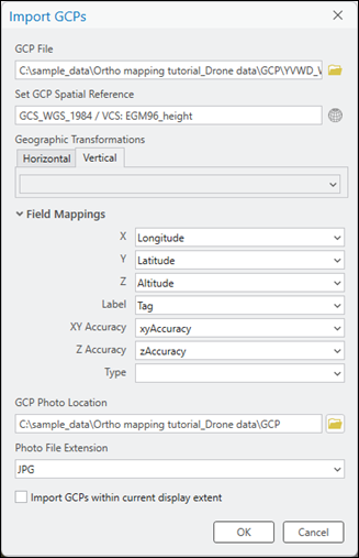

  2. In the GCP Manager window, click the Import GCPs button Import GCPs.
  3. In the Import GCPs window, under GCP File, browse to and select the YVWD_WGS84_EGM96.csv file, and click OK.

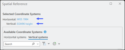

  4. For Set GCP Spatial Reference, click the Browse button
  5. For Horizontal systems, input WGS 1984 in the Search box and click Enter on the keyboard.
    For the Selected Coordinate Systems, the Horizonal will be WGS 1984 and Vertical will be EGM96.
  6. If the Vertical coordinate system was not auto populated click on Vertical systems and input EGM96 height in the Search box and expand Vertical Coordinate System, Gravity-related, and World, and choose EGM96 height.
    EGM96 will be displayed below Selected Coordinate Systems for Vertical.
    Spatial reference dialog
  7. Click OK in the Spatial Reference window to accept the changes and to be returned to Import GCPs window.
  8. Map the GCP fields accordingly under Field Mappings.
  9. Click the folder icon below GCP Photo Location, browse to and select the folder containing the images of the GCP locations.
  10. Click OK to accept the changes and close the Spatial Reference window.
    Import GCPs dialog
  11. Click OK again to accept changes to import GCPs.

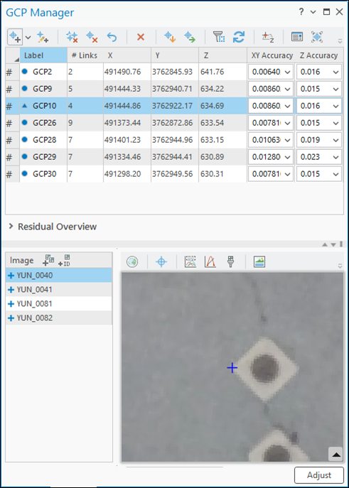

Add tie points for selected GCPs
To add tie points, complete the following steps:

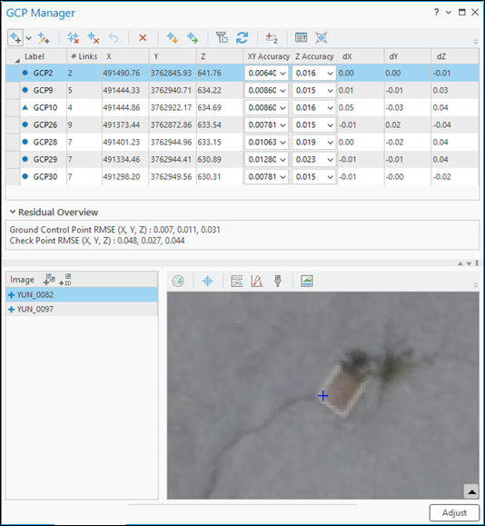

  1. In the GCP Manager window, GCP list section, select GCP2.
    All the images overlapping with GCP2 are listed in the Preview section at the bottom of the GCP Manager.
  2. In the Preview section, click on View GCP Photo button . An image depicting the location of GCP2 will be displayed to the bottom right of the viewer. Clicking the button again will remove the image.
    Rotating your mouse thumb wheel forward or backward enables image zoom functionality to assist with interpretation. Alternatively, you may navigate to the GCP folder on disk, expand it and double-click GCP2.jpg to get a larger view.
  3. Optionally, use the Dynamic Range Adjustment button to increase the image contrast.
  4. At the top of the GCP Manager, click the Semi-auto add tie point button to add a tie point in the image viewer identifying the GCP location.
    The tie points for other images will be automatically calculated by the image matching algorithm where possible, although each tie point should be checked for accuracy. A blue cross will appear to the left of the images with a digitized and auto generated tie point. If the tie point is not automatically identified, add the tie point manually by selecting the appropriate location in the image.
  5. Repeat Step 4 to add tie points for all remaining GCP’s.
  6. After each GCP has been added and measured with tie points, select GCP11 and right-click to change it to Check Point.
    There is some degree of uncertainty as to the correct surveyed location of this point in the drone images. Setting GCP11 as a Check Point will enable you to review its residuals without it skewing the adjustment results in case of errors in point measurement.
    In scenarios where there is no uncertainty in GCP point location measurement, assigning a Check Point status to a GCP will provide a measure of the absolute accuracy of the adjustment since this point will not be used in the adjustment process.
    GCP Manager window with a photo of the GCP location
  7. After adding GCPs and checkpoints, the adjustment must be run again to incorporate these points. Click Adjust to run the adjustment again to incorporate these points.
Review adjustment results
Adjustment quality results can be viewed in the GCP Manager window by analyzing the residuals for each GCP. Residuals represents the difference between the measured position and the computed position of a point. They are measured in the units of the project's spatial referencing system. After completing the adjustment with GCPs, three new fields—dX, dY, and dZ—are added to the GCP Manager table and display the residuals for each GCP. The quality of the fit between the adjusted block and the map coordinate system can be evaluated using these values. The root mean square error (RMSE) of the residuals can be viewed by expanding the Residual Overview section of the GCP Manager window.
Note:
The adjustment results shown in your project may differ from those illustrated below due to variations in point measurement and user-defined inputs. Small differences in measurement can affect the adjustment outcome and the resulting accuracy statistics.
GCP residuals in the GCP Manager window

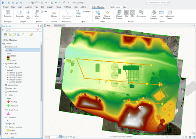

Generate a DSM
The stereo image pairs of an image collection are used to generate a point cloud (3D points) for which elevation data can be derived. The derived elevation data is classified as either a digital terrain model (DTM), which includes only the ground surface, or a digital surface model (DSM), which includes the elevations of trees, buildings, and other above ground features.
Note:
Elevation values can be derived when the image collection has a good amount of overlap to form the stereo pairs. Typical image overlap necessary to produce point clouds is 80 percent forward overlap along a flight line and 60 percent overlap between flight lines.
Follow the steps below to generate a DSM using the wizard.
  1. On the Ortho Mapping tab, click the DSM button in the Product group.
    The Ortho Mapping Products Wizard window appears.

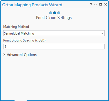

  2. Click Next to advance the wizard to the Point Cloud Settings window.
  3. In the Point Cloud Settings window, for Quality, choose Standard from the drop-down menu.
  4. For Matching Method, choose Semiglobal Matching from the drop-down menu.
    This method is typically used for images of urban areas and captures more detailed terrain information.
  5. Accept the default Point Ground Spacing value.
    This defines the spacing, in meters, at which the 3D points are generated. The default is three times the resolution of the source imagery.
  6. Accept all remaining default settings and click Next.
    For information on Advanced Settings, see Create elevation data using the ortho mapping DEMs wizard.

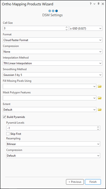

  7. In the DSM Settings page accept all remaining default settings and click Finish.
    DSM Settings
    The DSM will be generated.
    Ortho Mapping DSM displayed in the map

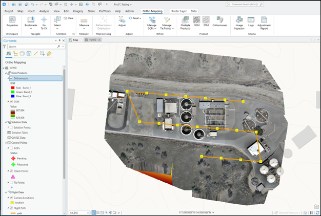

Generate an orthomosaic
An orthomosaic is an orthorectified image product mosaicked from an image collection. Geometric distortion has been corrected and the imagery has been color balanced to produce a mosaic.
  1. On the Ortho Mapping tab, in the Product group, click Orthomosaic to start the Orthomosaic Wizard.
  2. Ensure Color Balance and Generate Seamlines options are checked.
  3. Click Next.
    The Orthorectofication Settings pane appears.
  4. In the Orthorectification Settings window, under Elevation Source, select Use DEM Product and choose Digital Surface Model.
  5. Click Next.
  6. In the Color Balance Settings pane, for Balance Method, select Dodging from the drop-down list.
  7. For Color Surface Type ensure First Order is selected.
  8. Accept all remaining default settings and click Next.

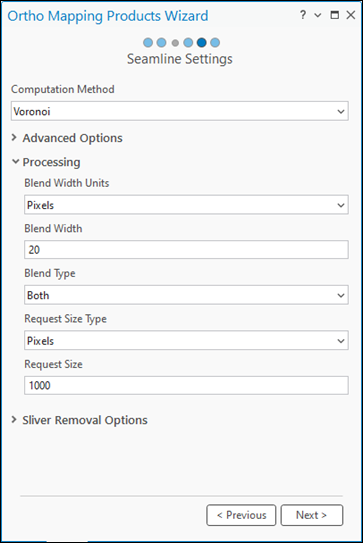

  9. In the Seamline Settings window, under the Computation Method drop-down menu, choose Veronoi.
  10. Expand the Processing section, and input 20 for Blend Width.
    Ortho Mapping seamline settings
  11. Accept all remaining default settings and click Next.
    The wizard guided workflow advances to the next pane, Orthomosaic Settings.
  12. Accept all the default settings in the Orthomosaic Settings pane, and click Finish.
    The orthomosaic will be generated, listed in the Contents pane, and loaded into the map display.
    Ortho mapping orthomosaic result
