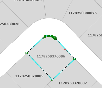

  4. After appending polygons, use the Simplify By Straight Lines And Circular Arcs geoprocessing tool to convert segmented (densified) curve edges on your polygons to true curves.
    Use this tool if your source data contains curves. Segmented curve edges on your polygons must be converted to true curves before building parcels to avoid tiny, individual lines being built for each segment. This tool detects and creates true curves from sequences of line segments using specified tolerances.
    Tip:
    Segmented curves occur when polygons or lines are appended to feature classes from shapefiles.
    Segmented curve edges on polygons must be converted to true curves before building parcels.
