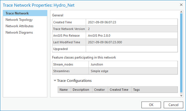

Trace network version
The Trace Network Version value indicates the schema version of the trace network dataset and is recorded in the Trace Network tab of the Trace Network Properties dialog box.
