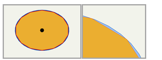

GeoAnalytics Server tools result in less densified features than other ArcGIS Pro tools. For example, the following images depict the result of vertices on a buffered polygon using the Buffer tool from the Analysis toolbox (blue), and the Create Buffers tool from the toolbox (orange). The first image shows the buffered polygons overlayed on each other, and the second image shows a zoomed-in view of some of the polygon vertices.
Buffered polygons using Analysis toolbox (blue) and GeoAnalytics Server toolbox (orange) tools
