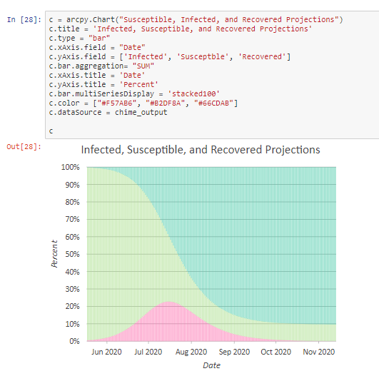

Charts assist in presenting information about map features and the relationship between them in a visual manner. Charts can also be created for nonspatial tables and can show additional information about the features on the map or the same information in a different way. Charts are complementary to maps in that they visually convey information that would generally be summarized numerically or explored from tables. With a chart, you can quickly compare features to gain insight into the functional relationship between the features and thereby visualize the distribution, trends, and patterns in the data that would otherwise be difficult to see.
Charts can be created using a Chart object and added to a layer or table in an ArcGIS Pro project. To add a chart to a layer in a project, create a Chart object, configure its properties, and associate the Chart object with an arcpy.mp.Layer from an arcpy.mp.ArcGISProject. A chart made in this way can be opened from the Charts section under the layer in the Contents pane when that project is opened in ArcGIS Pro.
The Chart object has a dataSource property that you can use to create a chart for data sources, including various feature class and table formats and web layers (feature services). A chart can be exported to an .svg file for visualization. Chart objects support rich representation in Notebooks and can be visualized graphically.
Example of chart in a notebook
