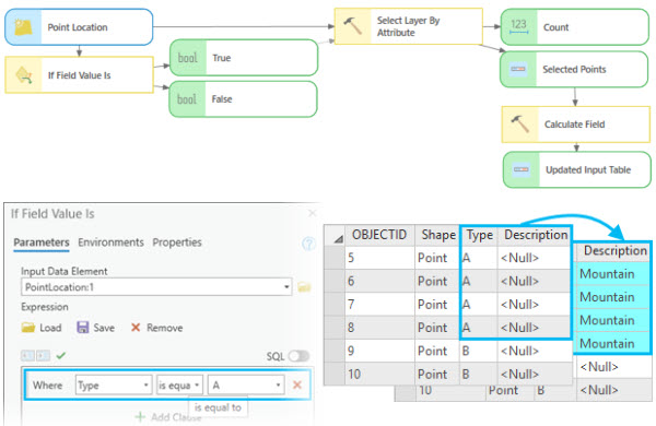

Modify field values based on a condition
The following example uses the If Field Value Is tool to check whether the input feature class has any records with the Type field value equal to A. If the Boolean output is True, select type A features using the Select Layer By Attribute tool, and modify the Description field values using the Calculate Field tool.
Example of If Field Value Is

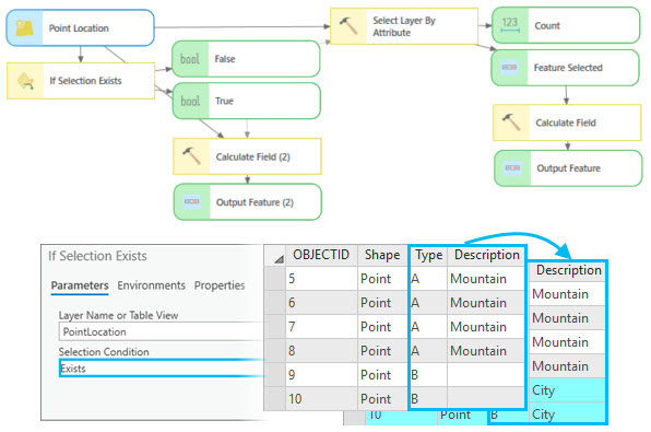

Run a model only if an SQL query results in any selected features
The following example uses the If Selection Exists tool to check whether the input feature class has any selected features. If the Boolean output is True, use the Calculate Field tool to calculate values of the Description field. If the Boolean output is False, use the Select Layer By Attribute tool to make the selection and modify field values.
Example of If Selection Exists

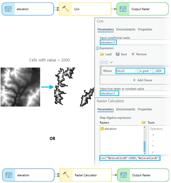

Perform a conditional evaluation of a raster
The Con or Raster Calculator tool can be used to conditionally evaluate a raster. In the following example, if a cell value is greater than 2000, then keep the input value, else set to NoData. Leaving the Con tool Input false raster or constant value parameter empty sets the value to NoData. Optionally, you can provide another raster or a constant value for the Input false raster or constant value parameter.
Raster conditional if...else evaluation

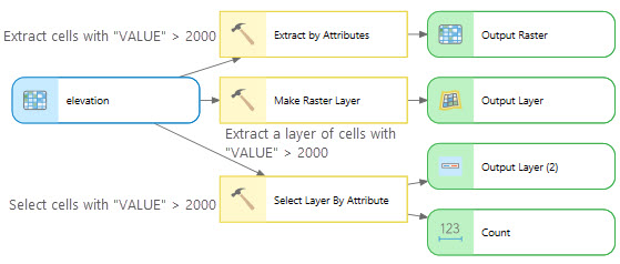

Extract cells from a raster with a query
The Extract By Attribute, Make Raster Layer, and Select Layer By Attribute tools can be used to extract cells from a raster. The following example shows methods to create a raster or a raster layer with cell values greater than 2000.
Raster extraction based on query

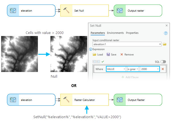

Extract cells from a raster with a query and set them to NoData
The Set Null, Reclassify, and Raster Calculator tools can be used to extract cells from a raster and set them to NoData. If the cell value is greater than 2000, then set to NoData, else use the input data value.
Raster set cell values to NoData.

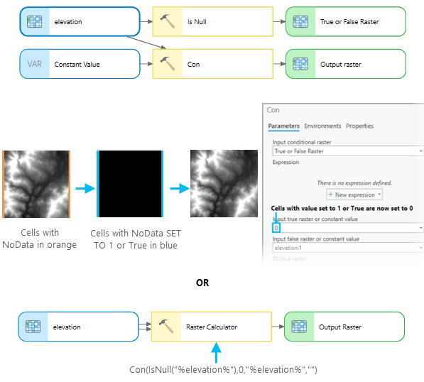

Extract NoData cells from a raster with a query and modify them
The Is Null tool with the Con tool, or the Raster Calculator tool can be used to extract NoData cells from a raster and modify them. In the following example, if a cell value is NoData, then set to 0, else use the input data value.
Modify the value of raster NoData cells.
