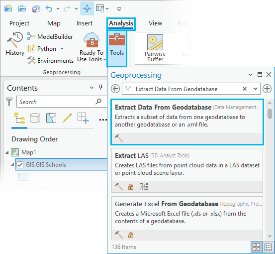

  1. To extract data from a geodatabase, open the Extract Data From Geodatabase geoprocessing tool using the Analysis tab and click Tools in the Geoprocessing group. You can also search for or browse to the Extract Data From Geodatabase tool in the Data Management Tools toolset in the General toolbox.
    Extract Data From Geodatabase tool under Analysis tab, Tools, and Geoprocessing

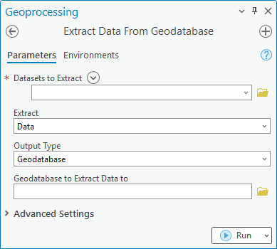

    The Extract Data From Geodatabase geoprocessing tool dialog box appears with default settings.

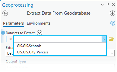

  2. For the Datasets to Extract parameter, use the browse button to select one or more datasets containing the data that will be extracted.

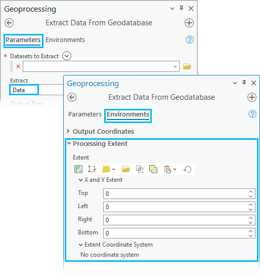

      Note:
      When the Extract parameter is set to Data, the Processing Extent options can be set under Environments and the Output Coordinate System value is ignored.
      When Data is set as the extent for the Extract Data From Geodatabase tool, the processing extents under Environments are enforced.

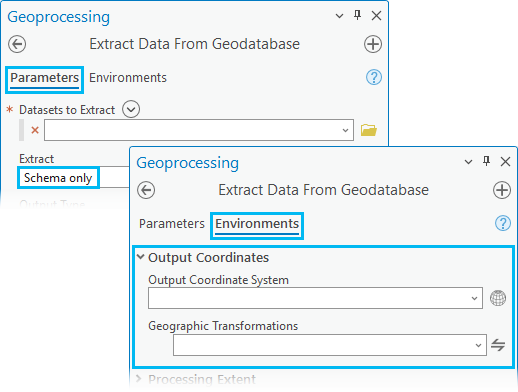

    • Schema only—Only the schema will be extracted.
      Note:
      When the Extract parameter is set to Schema only, you can set the Output Coordinate System value on the Environments tab and the Processing Extent setting is ignored.
      However, changing the Output Coordinate System value is not supported if the Output Type parameter is set to XML file.
      When Schema only is set as the extent for the Extract Data From Geodatabase tool, the output coordinate system under Environments is enforced.
  4. Optionally, select one of the following from the Output Type drop-down menu:
    • Geodatabase—The data will be extracted to an existing geodatabase. This is the default.
      In the Extract Data From Geodatabase tool, Output Type is set to Geodatabase.
      If you choose Geodatabase (the default setting), click the browse button next to Geodatabase to Extract Data to and browse to the geodatabase where the data will be extracted to. This geodatabase can be a file, mobile, or enterprise geodatabase.

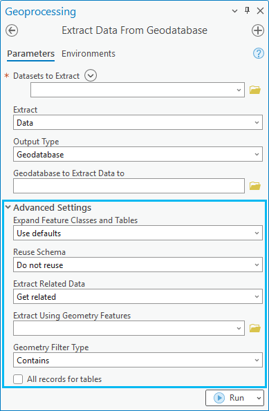

  5. Click Advanced Settings to expand additional options to override the Extract Data From Geodatabase tool default options. If you are not changing the default options, skip to step 12 to run the tool.
    Advanced Settings in the Extract Data From Geodatabase tool
  6. Optionally, choose one of the following options from the Expand Feature Classes and Tables drop-down menu to specify whether the expanded feature classes and tables—such as those in networks, topologies, or relationship classes—will be added.
    • Use defaults—The expanded feature classes and tables related to the feature classes and tables in the input datasets will be added. The default for feature classes is to extract all features intersecting the spatial filter. If no spatial filter has been provided, all features will be included. The default for tables is to extract the schema only. This is the default.
    • Add with schema only—The schema for the expanded feature classes and tables will be added.
    • All rows—All rows for expanded feature classes and tables will be added.
    • Do not add—No expanded feature classes or tables will be added.
  7. Optionally, choose one of the following options from the Reuse Schema drop-down menu to specify whether the geodatabase containing the schema of the data to be extracted will be reused.
    Reusing the schema reduces the amount of time required to extract the data.
    • Do not reuse—The schema will not be reused. This is the default.
    • Reuse—The schema will be reused.
    Note:
    • The Reuse Schema parameter is only available if the Output Type parameter is set to Geodatabase.
    • Choose the Reuse option only if the output geodatabase contains the schema of your datasets and no data.
  8. Optionally, choose one of the following options from the Extract Related Data drop-down menu to specify whether rows related to existing rows in the data will be extracted, for example, a feature (f1) is inside the geometry filter, and a related feature (f2) from another class is outside the filter.
    If you choose to get related data, feature f2 is included in the extracted data in the example.
    • Do not get related—Related data will not be extracted.
    • Get related—Related data will be extracted. This is the default.
  9. Optionally, click the browse button next to the Extract Using Geometry Features parameter and browse to the features that will be used to define the area to extract.
  10. Optionally, choose one of the following options from the Geometry Filter Type drop-down menu to specify the spatial relationship between the Extract Using Geometry Features and Input Datasets parameter values and how that relationship will be filtered.
    The spatial relationship is applied to data in an extent defined by the area of interest (AOI) specified in the Extract Using Geometry Features parameter.
    • Intersects—Features in the Input Datasets parameter value that intersect features in the Extract Using Geometry Features parameter value will be extracted.
    • Contains—Features in the Input Datasets parameter value contained by the selected feature in the Extract Using Geometry Features parameter value will be extracted.
  11. Optionally, use the All records for tables check box to specify whether all records or only the schema will be extracted for tables without filters (such as selections or definition queries).
    Tables with applied filters will be honored.
    • Checked—All records will be extracted to the geodatabase. This option will override the Expand Feature Classes and Tables parameter value.
    • Unchecked—Only the schema will be extracted to the geodatabase for tables. This is the default.
