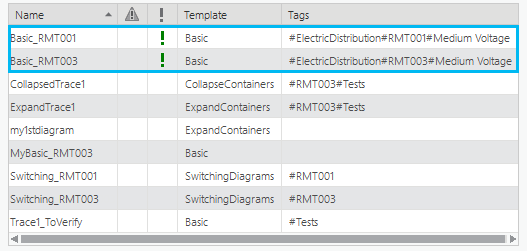

Like any other diagrams you create yourself and store in the database, the subnetwork system diagrams can be retrieved using the Find Diagrams function .
In the Find Diagrams pane that appears, the subnetwork system diagrams are identified by a green exclamation point in the third column of the diagrams list, and their tags list the domain, tier name, and subnetwork name they are tied to.
Subnetwork system diagrams in the Find Diagrams pane
Caution:
Disabling the network topology causes all subnetworks to become dirty and all subnetwork system diagrams to be no longer flagged as system. In this situation, after reenabling network topology, updating the subnetworks will restore the subnetwork system diagram flags.
Subnetwork system diagram names
The name of the subnetwork system diagram merges the name of the diagram template it is based on and the subnetwork name in the Subnetwork name field, and it is formatted as follows: <DiagramTemplateName>_<SubnetworkName>.

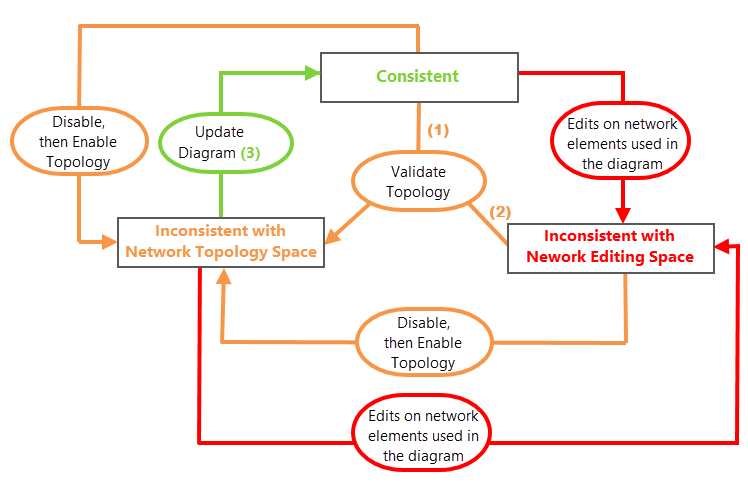

Whether the diagram is a subnetwork system diagram or not, the management of its consistency state regarding the network space is slightly different.
Consistency state regarding the network space on nonsystem diagrams
(1)—Validate topology on an extent that intersects the diagram geographic area.
(2)—Validate topology after editing network features or network objects that are used in the diagram.
(3)—Update Diagram is the most common operation to run to make an inconsistent diagram switch back to a consistent state. However, running the Overwrite Diagram, Append Diagram, or Extend Diagram tool on an inconsistent diagram also changes the consistency state of the input diagram.

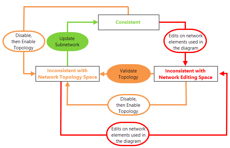

Consistency state regarding the network space on subnetwork system diagrams
Consistency state on subnetwork system diagrams
Note:
After disabling the utility network topology, subnetwork system diagrams are no longer flagged as system diagrams. This flag is restored when running the Update Subnetwork tool.
As explained in the images above, a subnetwork system diagram switches from consistent to inconsistent with the network editing space after utility network features or network objects that are used in the diagram are edited. Validating network topology on an extent that intersects a subnetwork system diagram's geographic area doesn't make it become inconsistent with the network topology space like it does for a nonsystem diagram. However, when there are more than one subnetwork controller associated with the edited subnetwork, any associated subnetworks and so the related system diagrams become inconsistent with the network topology space after its validation.
The only way to make an inconsistent subnetwork system diagram switch back to a consistent state is by running the Update Subnetwork tool.
