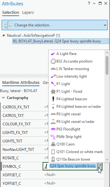

ArcGIS Maritime uses attribute-driven symbology to connect symbol properties to attributes in the data. The data model is preconfigured with cartographic fields that are used to change the symbol and its properties, such as offset or rotation. Attribute-driven cartographic refinement can be performed on the Maritime Attributes tab in the Attributes pane.
Selection list in the Symbol_C field of the Maritime Attributes pane
Similar to attribute-driven cartography, the individual annotation symbol attributes and annotation formatting can also be managed in the Attributes pane. Annotation features can also be edited on the map using the Annotation tool in the Modify Features pane.

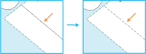

Symbology suppression
It may be necessary to hide a portion of a line or polygon outline where multiple features overlap. You can enable control points to apply the Suppress symbol effect and mark the segments you want to hide without altering feature geometry.
