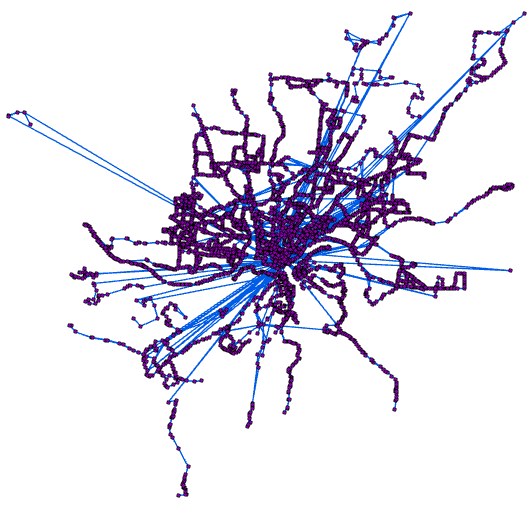

  8. Examine the output in the map and in the Contents pane.
    Two feature classes, Stops and LineVariantElements, and several tables are shown. The tables represent the public transit schedules. The Stops feature class represents the locations of the transit stop. The LineVariantElements feature class represents the transit line segments.
    Output of the GTFS To Public Transit Data Model tool in the map
    The transit lines in the map do not follow the streets and do not look like a typical visual representation of the transit system. The LineVariantElements features are not intended to represent the actual geographic paths taken by buses, trains, or other public transit vehicles but are instead representative of logical connections in the transit system. The Public Transit evaluator in the network dataset will use the public transit schedules to determine the travel time required to traverse the LineVariantElements features, so their shape and length are irrelevant. These feature classes and tables are described in more detail in the Network Analyst public transit data model documentation.
    You may notice that the LineVariantElements feature class contains several long, straight lines. These represent express routes that connect the center of the city to stops in the outskirts, with no intermediate stops.

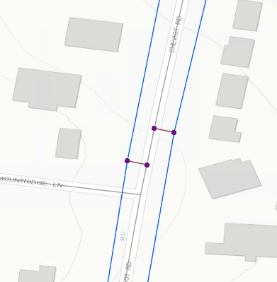

  8. Zoom in to the area around one of the public transit stops and examine it.
    You should see the Stops feature, a short straight line segment (a StopConnectors feature) connecting that Stops feature to a street, and a StopsOnStreets feature at the intersection of the street and the StopConnectors line feature. This combination of features allows you to define good, well-controlled connectivity between the streets and public transit lines in the network dataset. These feature classes are described in more detail in the documentation for the Network Analyst public transit data model.
    Transit lines connected to streets.

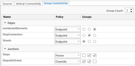

    1. On the network dataset properties dialog box, select Source Settings > Group Connectivity.
      The Group Connectivity tab appears.
      The Group Connectivity tab lists feature classes and their connectivity policies and groups.
    2. Examine the list of feature classes.
      The transit lines (LineVariantElements), streets, and connector features (StopConnectors) are included in the network as edge sources. The transit stops (Stops) and the copy of the stops that is snapped to the streets (StopsOnStreets) are included in the network as junction sources.
      Note:
      If you're using data from the StreetMap Premium Custom Roads product, you will see Routing_Streets instead of Streets, and Routing_Streets_Override is included as an additional junction source.
    3. Examine the connectivity groups.
      The network dataset has three connectivity groups. The streets are in the first group, the connector lines are in the second group, and the transit lines are in the third group. The StopsOnStreets feature class participates in both the first and second groups, providing a way for the traveler to transition between the streets and the connector lines. The Stops feature class participates in the second and third groups, providing a way to transition from the connector lines to the transit lines.
      Note:
      If you're using data from the StreetMap Premium Custom Roads product, Routing_Streets_Override participates in the same connectivity group as Routing_Streets.
    4. Examine the connectivity policies for the edge sources.
      All three edge sources have Endpoint connectivity, which means that line features are only considered connected in the network if their endpoints are coincident. If they touch or overlap at other points, they are not considered connected.
      LineVariantElements and StopConnectors should always use Endpoint connectivity.
      Earlier in this tutorial, you examined the street data in the map to determine whether it was split into separate features at each intersection or whether it had long contiguous street features that went through several intersections with other streets. For street data that is split at every intersection, Endpoint connectivity is the correct choice. The provided street data is split into separate features at every intersection, so leave the connectivity policy for Streets as Endpoint.
      Note:
      If you are using your own street data, and your streets include long contiguous street features that are not split at each intersection, switch the Streets connectivity policy to Any Vertex.
      If you're using data from the StreetMap Premium Custom Roads product, leave the connectivity policy of Routing_Streets set to Endpoint, even though this street data is not split at each intersection. The Routing_Streets_Override junction source, with its connectivity policy of Override, serves to ensure proper connectivity at these intersections.
    5. Examine the connectivity policies for the junction sources.
      The Stops junction source has a connectivity policy of Honor, which means that transit stops obey the connectivity policy of the edge source to which they are connected.
      The StopsOnStreets junction source has a connectivity policy of Override, which means that these junctions will override the connectivity policy of the edge source to which they are connected. In this case, StopsOnStreets features will connect to Streets features at junctions even if the Streets connectivity policy is Endpoint. This is important because it means that you do not need to split the street features at the locations of transit stops to ensure connectivity in the network.
      Leave the junction source connectivity policies as they are.

    The most likely build errors you may encounter are those indicating that StopConnectors features have an empty geometry. Messages like SourceName: StopConnectors, ObjectID: 232, Geometry is empty are common in this scenario. This typically occurs when one of the Stops features and its associated StopsOnStreets feature are spatially coincident because the StopsOnStreets feature did not successfully snap to a nearby street. Consequently, the connector line generated between the two has no length.
    If you have build errors of this type, examine the affected StopConnectors features. You can find the associated Stops and StopsOnStreets features using the StopID field in StopConnectors, which refers to the ID field in Stops and StopsOnStreets. The most likely cause of the error is that the stop was farther from the closest street than the Search Distance you used in the Connect Public Transit Data Model To Streets tool. The stop may be in the wrong place, which indicates an error in the original GTFS data, or the street data may be missing some roads or driveways that service the stop.
    If there are only a few errors, and they are not in an area that is important for your analysis, you can safely ignore them.
    If you want to correct the problem, you need to manually move the StopsOnStreets feature and snap it to the correct point along a street and edit the StopConnectors feature to connect to it. The easiest way to correct a null geometry is to use the Replace Geometry editing tool. The direction of digitization of the StopConnectors features should be from the stops toward the streets. You should not move the Stops feature in case it becomes disconnected from the transit lines. You can also edit the street data to add missing roads or driveways before editing StopsOnStreets.
    Instead of editing, you can rerun the Connect Public Transit Data Model To Streets tool with a larger Search Distance value.
    Another build error you may encounter occurs when the original stop location is already spatially coincident or nearly coincident with a street. In this case, the Stops feature and its associated StopsOnStreets feature are spatially coincident or nearly spatially coincident because the snapping process did not move the StopsOnStreets feature from its original location, and the line generated between them has no length or a very tiny length that is too small for use in a network dataset. Messages like SourceName: StopConnectors, ObjectID: 232, The edge feature is too small to participate in snapping and may not be connected to other features are common in this scenario.
    As long as the Stops feature and its associated StopsOnStreets feature are spatially coincident, proper network connectivity will be maintained, and the network will be able to model travelers boarding and alighting at this stop. However, if you plan to model a time cost for boarding and alighting by adding an impedance to the StopConnectors features, boardings and alightings at this stop will likely not incur the desired time cost impedance since it is not necessary to traverse the connector or the connector is not included in the network dataset.
    If you want to correct the problem, you need to manually move the Stops feature and the endpoints of all LineVariantElement features connected to it so that they are no longer spatially coincident with a street. Afterward, if necessary, edit the StopConnectors feature to properly connect the Stops feature and its associated StopsOnStreets feature. The direction of digitization of the StopConnectors features should be from the stops toward the streets.
    Learn how to use map topology to maintain connections between features when moving them

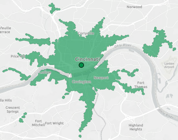

  1. On the Service Area Layer tab, in the Analysis group, click Run .
    A service area polygon is generated in the map. This polygon represents the area reachable from the facility by public transit and walking within 30 minutes of travel time if the traveler starts at the time of day you specified. It should extend from the facility along some of the public transit lines in your system.
    Your output service area polygons may include multipart features showing seemingly disconnected areas around transit stops or stations. This is expected and correct. If you're creating a 30-minute service area, your traveler could exit the train at a station after traveling for 25 minutes and walk for 5 minutes, or they could continue traveling and exit the train at the next station after 28 minutes and have only 2 minutes remaining for walking. However, since trains typically go faster than people walk, the walking traveler could not reach all the areas between the two stations without exceeding the 30-minute travel time limit. Consequently, a small area around each station is reachable within 30 minutes, but much of the area between the stations is not, and the 30-minute Service Area polygon will contain each of these disconnected areas surrounding the reachable stations.
    Public transit service area at 5:15 p.m.

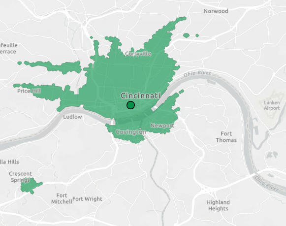

  2. On the Service Area Layer tab, in the Date and Time group, change the Time value to a different time of day of your choice. For example, choose a time of day during off-peak hours when there is less public transit service available, such as 2:00 PM.
    Note:
    If the Service Area Layer tab is not visible, in the Contents pane, click Service Area to select the group layer.
  3. On the Service Area Layer tab, in the Analysis group, click Run .
    The service area polygon is altered. The service area now represents the reachable area if the traveler starts at the new time of day you specified. Because the available public transit service is different at different times of day, the area reachable by a traveler using that public transit service will be different.
