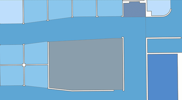

    The Erase tool extracts the areas between the different units features representing walls for the selected floor.
    Walls extracted for a floor

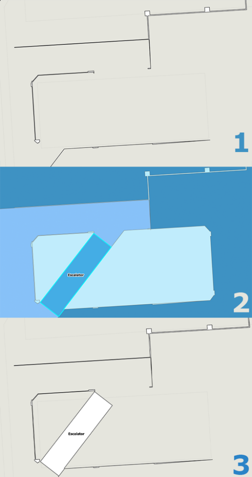

Add special units
Sometimes, certain features that represent built structures such as escalators or pillars cannot be extracted as walls. To manually add them to the Walls feature class, complete the following steps:
  1. Start ArcGIS Pro.
  2. Open an ArcGIS IPS map or prepare a new map in ArcGIS Pro.
  3. Add the Units feature class to the map.
  4. Identify and select features that represent a special unit.
  5. Copy the features to the clipboard and paste them in the Walls feature class using the Paste Special command.
    Note:
    You can also select the features and use the Append tool to add them to the Walls feature class.
    Add special unit features to the Walls feature class.
  6. Repeat steps 4 and 5 for each available floor.
Special units are added to the Walls feature class. Verify that the added features contain the correct LEVEL_ID value.

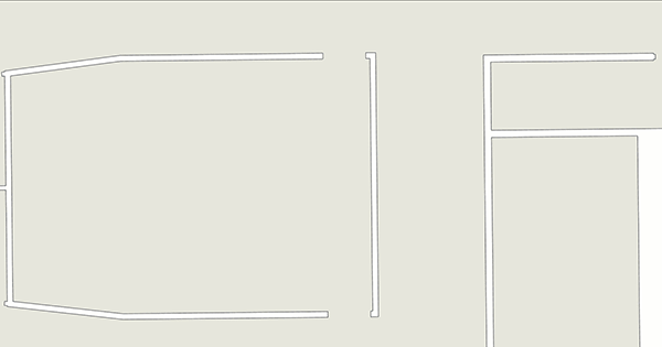

Correct wall data
Inaccuracies in the Units feature class data can result in an incorrect spatial representation of your indoor space. This can result in the following:
  • The absence of certain walls or other building features from the final output feature class
  • Redundant wall features in the final output feature class

Add missing wall feature.
