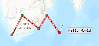

To add a custom sketch tip, use the SketchTip property. Or if a more complex tip is required, use an embeddable control and reference it's daml ID using the SketchTipID property. The embeddable control can be referenced using the SketchTipEmbeddableControl property. These properties are available at 3.0 onwards.
public CustomEditTool() {
IsSketchTool = true;
SketchType = SketchGeometryType.Line;
SketchTip = "hello world";
If you are using an embeddable control for a sketch tip, then from 3.4 onwards you can customize some additional properties. By default a sketch tip is located to the lower-right of the cursor and has a grey background. Change the position of the sketch tip by specifying a value for the SketchTipControlPosition property. The background of the sketch tip can also be set to transparent by setting the IsSketchTipControlTransparent to true. Note that these two properties can only be used if a SketchTipID is set.
public SketchToolHalo()
SketchOutputMode = SketchOutputMode.Map;
SketchTipID = "SketchToolWithHalos_HaloEmbeddableControl";
SketchTipControlPosition = SketchTipControlPosition.Center;
IsSketchTipControlTransparent = true;
See the ProGuide Sketch Tip With Halos and the associated Sketch Tool Halo Sample for an example of using the SketchTipID, SketchTipControlPosition and IsSketchTipControlTransparent properties.

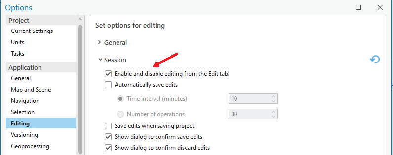

Enable and Disable Editing
Editing in the application, starting at 2.6, can be enabled and disabled via the UI. For users this means first checking on the "Enable and disable editing from the Edit tab" in the Session section of the Editing options on the Pro backstage.
If this checkbox is checked, the "Toggle editing on/off" button becomes visible on the Edit UI ribbon and users must enable editing within a project before doing any edits (they can also disable editing or "toggle it off" once they have enabled it or "toggled it on"). If the "Enable and disable editing" checkbox has been checked, then editing must always be enabled for any project after it is opened; the editing state of a project is not preserved on close.
The "Enable and disable editing from the Edit tab" checkbox in the UI corresponds to the ApplicationOptions.EditingOptions.EnableEditingFromEditTab setting within the application options. Toggling the value of EnableEditingFromEditTab true and/or false via code is equivalent to toggling the checkbox on|off via the UI. The complete list of available editing options in the api are listed in the Editing options section.
Custom editing tools and buttons that want to be enabled and disabled in concert with the Pro editing tools, in response to the editing status of the application, can use either the pre-existing esri_editing_EditingPossibleCondition condition or, for (map) tools, they can use the slightly more robust esri_editing_EditingMapCondition condition which additionally checks that a 2D map has been activated. If a user disables editing via the UI, Edit Operations in core tools and add-ins will not execute and return false (see "EditOperation" sub-section below).

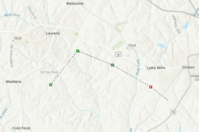

Snap Results
You can determine what features the sketch has snapped to in your custom tools through the map tool property SnappingResults. This returns a readonly list of SnapResult for each vertex in the current sketch. For those vertices that have snapped to a feature or the grid, SnapResult contains the layer, feature OID, SnapType (vertex, edge, end etc) and the snap location. For those vertices that have not snapped in the sketch, SnapResult contains null for the layer, -1 for the feature OID and the SnapType type is None.
If the sketch has snapped to the editing grid, SnapResult contains null for the layer, the SnapType is Grid, the OID denotes the grid feature: 0 for a grid line, 1 for a grid intersection and 2 for grid inference.
protected override Task<bool> OnSketchCompleteAsync(Geometry geometry)
//assume a custom point map tool
//get the feature the point sketch snapped to if any
var snapResultPoint = SnappingResults[0];
if (snapResultPoint.Layer != null)
var snappedLayer = snapResultPoint.Layer;
var snappedOID = snapResultPoint.ObjectID;
var snapType = snapResultPoint.SnapType;
if (snapType == SnapType.Grid)
// we snapped to the grid
var gridLine = (snappedOID == 0);
var gridIntersection = (snappedOID == 1);
var gridInference = (snappedOID == 2);
else if (snapType != SnapType.None)
// we snapped to a feature
// use (snappedLayer, snappedOID)

Single Workspace Editing
If the application has "Enable and disable editing from the Edit tab" enabled in the backstage Editing options (see Enable and Disable Editing), then users have the additional option of defining the type of edit session that will be used by the application; either multiple workspace editing or single workspace editing. Single workspace edit sessions are as they sound. When users enable editing (by clicking the "Toggle editing on/off" button to on), they must specify the single workspace that will be edited. The application commences an edit session on that workspace and only data within that workspace will be available to edit. All other data within your project that belongs to different workspaces will be read-only. If a user wishes to edit data from a different workspace, then any edits within the existing single workspace edit session must be saved or discarded, the edit session stopped (by clicking the "Toggle editing on/off" button to off) and a new edit session started on the different workspace.
Developers can use the SetSingleEditWorkspaceAsync extension method to specify a single workspace to edit. The EditingOptions.EnableEditingFromEditTab and
EditingOptions.IsSingleWorkspaceEditSession must both be true for this API method to succeed. If either of these application options are false, then the SetSingleEditWorkspaceAsync method will throw an InvalidOperationException.
There are a number of different ways to call the SetSingleEditWorkspaceAsync method. The simplest is to start a single workspace edit session using a specific MapMember within a Map. Here is an example

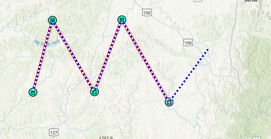

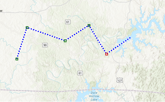

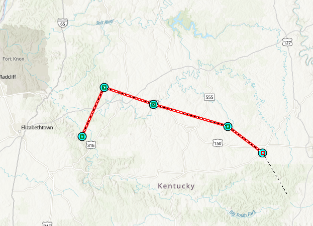

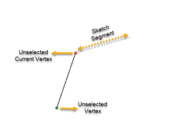

Sketch Feedback and Sketch Symbology
The MapTool sketch feedback consists of vertices and segments. A vertex can be fixed or it can be the active or current vertex. The default symbology for a fixed vertex is a hollow green square; whereas the default symbology for the current vertex is a hollow red square. Similarly, segments are either fixed or the active / current segment. There is no difference in the symbology between fixed or current segments; all sketch segments have the default symbology of a black dash-dot line; commonly referred to as the ant-trail. All vertices and segments whether they are fixed or current comprise the sketch feedback. The following displays the default sketch feedback showing the vertex and segment symbols.
Within a custom MapTool, you can customize the sketch symbol using the SketchSymbol property. Typically you would set this in the OnToolActivateAsync method. Alternatively you could use the OnSketchModifiedAsync method if you wanted to make the modifications more dynamic (for example changing the sketch symbol's color based on the number of vertices in the sketch).
Here's a code snippet for setting the SketchSymbol property in OnToolActivateAsync
private CIMLineSymbol _lineSymbol = null;
protected override async Task OnToolActivateAsync(bool hasMapViewChanged)
if (_lineSymbol == null)
_lineSymbol = await Module1.CreateLineSymbolAsync();
this.SketchSymbol = _lineSymbol.MakeSymbolReference();
And the result. Note that you can still see the green and red vertex squares along with the dash-dot ant-trail line of the sketch feedback overlaying the sketch symbol.
Starting with Pro 2.9, you can also change the symbology of the vertices and segments of the sketch feedback in your custom MapTool. There are 4 different types of vertices - unselected vertex, selected vertex, unselected current vertex, and selected current vertex. For the purposes of sketching all vertices are unselected. Selected vertices are only visible within the Edit Vertices tool. As previously mentioned, the default vertex symbology whilst sketching is the green hollow square (unselected vertex) and the red hollow square (unselected current vertex). The default symbology for vertices within the Edit Vertices tool is a green filled square (selected vertex) and a red filled square (selected current vertex). The images below illustrate this; the first shows the unselected vertex symbology whilst sketching; the lower images show the selected vertex symbology within Edit Vertices.
You can modify the vertex and segment symbology of the sketch feedback using the following new methods on the MapTool class:
- GetSketchVertexSymbolOptions - Gets the symbol for a vertex while sketching.
- SetSketchVertexSymbolOptions- Sets the symbol for a vertex while sketching.
- GetSketchSegmentSymbolOptions- Gets the default segment sketching symbol information.
- SetSketchSegmentSymbolOptions- Sets the segment sketching symbol information.
- ResetSketchVertexSymbolOptions- Sets the current sketch vertex symbols back to the options defined in the application settings.
- ResetSketchSegmentSymbolOptions- Sets the current sketch segment symbol back to the options defined in the application settings.
Symbology set via these methods override the default symbology defined in the application settings. Here's a code snippet showing how to customize the segment symbol of the sketch feedback. In this example, the ant-trail becomes a blue dash-dot line of width 2.5. Note it is not possible to change the segment symbol type. It continues to be constrained to be a dash-dot line.
protected override Task OnToolActivateAsync(bool active)
return QueuedTask.Run(() =>
var options = GetSketchSegmentSymbolOptions();
var blue = new CIMRGBColor();
blue.R = 0;
blue.G = 0;
blue.B = 255;
options.PrimaryColor = blue;
options.Width = 2.5;
SetSketchSegmentSymbolOptions(options);
A sample tool modifying sketch feedback can be found at CustomToolSketchSymbology.

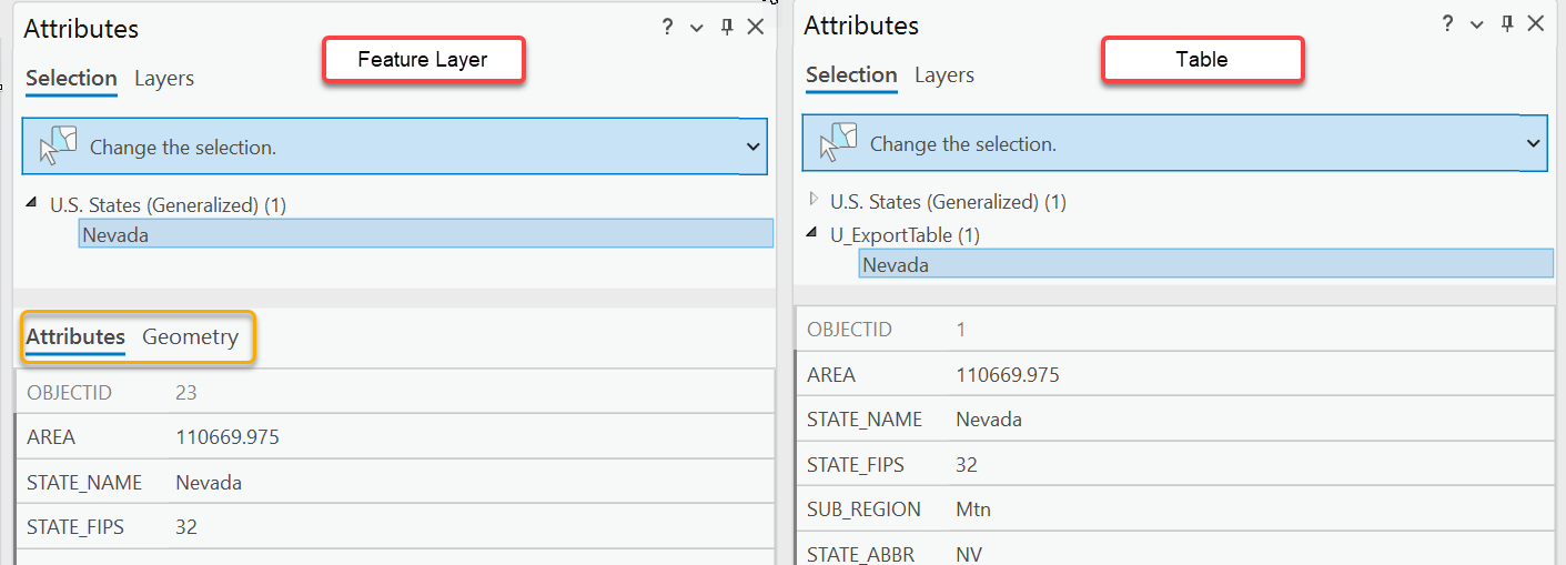

Customizing the Attributes Dockpane
Adding Tabs
The Attributes dockpane in ArcGIS Pro displays information for the selected features in a feature layer or selected rows in a standalone table. This information is displayed in a series of tabs in the lower half of the dockpane. Examples of these tabs are the Attributes and Geometry tabs.

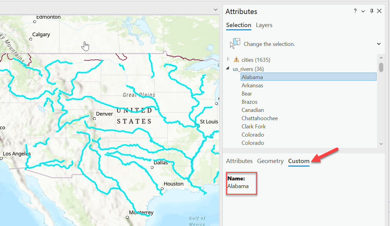

At 3.1, the Attributes dockpane can be extended to display a custom tab. In the screenshot below, a tab called "Custom" has been added to the Attributes dockpane. In this example, the tab displays the name of the selected feature.
The following development process outlines how to achieve this special behavior.

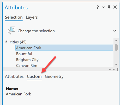

After following these steps, the custom tab will appear in the Attributes dockpane when a feature or row from the registered feature class or table has been highlighted in the treeview and it meets the criteria (if any) in the Applies method.

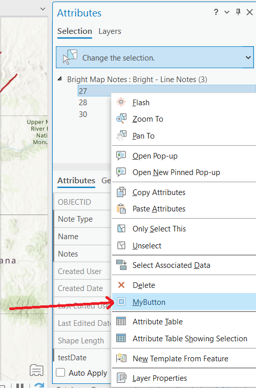

Adding Commands to the Context Menu
The process of adding a command to a context menu requires two steps:
- a new ArcGIS Pro Button needs to be created.
- the context menu needs to be updated with the new command inserted into the appropriate location.
In the case of adding a new command to the context menu of the treeview part of the Attributes dockpane, multiple context menus need to be updated as each context menu applies to different scenarios. The context menu DAML Ids used in the treeview part of the Attributes dockpane are:
esri_editing_Attributes_FeatureContextMenu- displayed when a feature is right-clickedesri_editing_Attributes_NonFeatureRowContextMenu- displayed when a row from a table is right-clickedesri_editing_Attributes_LayerContextMenu- displayed when a layer is right-clickedesri_editing_Attributes_TableContextMenu- displayed when a table is right-clicked
Here's a screenshot of a custom button added to the esri_editing_Attributes_FeatureContextMenu.
When writing a command that is to be inserted into a context menu, the typical pattern is to use the FrameworkApplication.ContextMenuDataContext method to obtain a representation of the item that was clicked on; that is the context. Sometimes it is possible to cast this context directly to an API object. For example, when inserting a command into the esri_mapping_mapContextMenu menu (displayed when a map is right-clicked in the Table of Contents), the context is the Map object.
In other situations, the context has to be retrieved using a different methodology; that is the internal object representing the context is responsible for translating some parts of it's data into an API class. Programmatically this is achieved by using the FrameworkApplication.ContextMenuDataContextAs
The Attributes dockpane uses this second methodology to obtain it's context which is either a MapMember and object ID (when a single row is right clicked) or a MapMember and a set of object IDs (when the MapMember is right clicked or a set of rows are right-clicked). Both of these scenarios are represented by the SelectionSet class. Retrieving the context can be written as follows:
var sSet = FrameworkApplication.ContextMenuDataContextAs<SelectionSet>();
Here's a complete code snippet illustrating how to obtain the context as a SelectionSet; the OnClick method of the button performs a Delete operation.
protected override async void OnClick()
await QueuedTask.Run(async () =>
if (sSet == null)
return;
int count = sSet.Count;
if (count == 0)
return;
var op = new EditOperation();
op.Name = "Delete context";
op.Delete(sSet);
await op.ExecuteAsync();
In addition to the code, the context menu also needs to be updated in the daml. You can achieve this by updating the Editing module and modifying the following set of menus as appropriate.

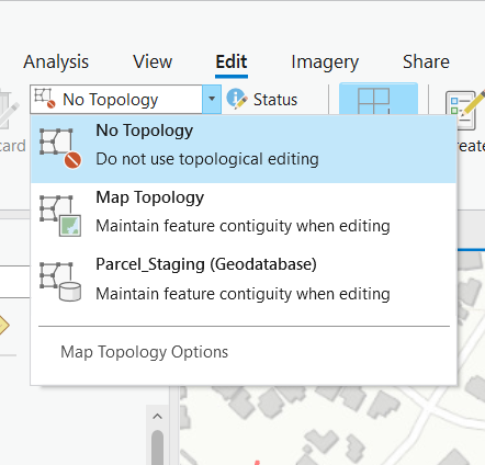

Topology
Topology Properties
Introduced at 3.1 are a number of classes that represent topology properties. TopologyProperties is the abstract base class. Deriving from this are the GeodatabaseTopologyProperties, MapTopologyProperties and NoTopologyProperties classes.
These classes represent the topological editing options shown in the Topology dropdown on the Edit tab as shown below. Note that topological editing only applies to 2D non-stereo maps.
Extension methods on the Map class can be used to interact with these topology property classes. Use GetAvailableTopologiesAsync to retrieve the set of topologies present in the current map or GetTopologyAsync to retrieve a specific topology by name.
The active topology properties can be retrieved using GetActiveTopologyAsync. Set the map topology as active using the combination of CanSetMapTopology and SetMapTopologyAsync or set a specific geodatabase topology as active by CanSetActiveTopology and SetActiveTopologyAsync. Set the active topology to "No topology" using the CanClearTopology and ClearTopologyAsync methods.
Here are some snippets illustrating the methods referenced above.

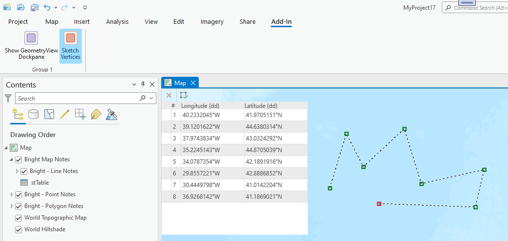

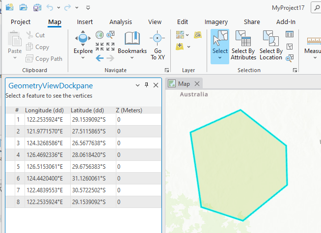

Geometry Vertices
The Geometry control provides a UI for viewing vertices. The GeometryMode dependency property provides two options to configure the control - set it to GeometryMode.Geometry to view the vertices of a geometry or GeometryMode.Sketch to view the vertices of a sketch.
In GeometryMode.Geometry mode, the control acts the same as the Geometry tab on the Attributes pane. Bind the geometry to be loaded into the grid to the Geometry property of the control. This geometry can be one that is created on-the-fly or a geometry of an existing feature. If the geometry is Z-aware or M-aware the control will display the Z and/or M values.
<UserControl x:Class="Example.GeometryViewDockpane"
... xmlns:editControls="clr-namespace:ArcGIS.Desktop.Editing.Controls;assembly=ArcGIS.Desktop.Editing"
<Grid>
<editControls:GeometryControl GeometryMode="Geometry" Geometry="{Binding Geometry}"/>
</Grid>
The Geometry property in the associated (dockpane) view model is defined as:
private Geometry _geometry;
public Geometry Geometry
get => _geometry;
set => SetProperty(ref _geometry, value);
In GeometryMode.Sketch mode, the control responds to sketching on the map view allowing you to view and modify the vertices of the current sketch. If the SketchLayer property is set; the properties of the layer's feature class determine whether the GeometryControl displays Z and/or M values as you sketch. If no SketchLayer is set, the GeometryControl only displays X,Y coordinates. When the sketch is finished or canceled, the control is cleared.
<Grid>
<editControls:GeometryControl GeometryMode="Sketch" SketchLayer="{Binding SketchLayer}"/>
</Grid>
The SketchLayer property in the associated (dockpane) view model is defined as:
private BasicFeatureLayer _sketchLayer;
public BasicFeatureLayer SketchLayer
get => _sketchLayer;
set => SetProperty(ref _sketchLayer, value);
Two new properties are available in the ArcGIS Pro 3.5 release. The ShowSelectionTab property indicates whether the Selected Vertices tab is displayed. The default value of this property is false meaning that the tab is not displayed. When the ShowSelectionTab property is true, the ViewMode property allows you to programmatically set the active tab.
Here is sample xaml and view model code defining these properties.
<Grid>
<editControls:GeometryControl GeometryMode="Geometry" Geometry="{Binding Geometry}" ShowSelectionTab="{Binding ShowSelectionTab}"
ViewMode="{Binding ViewMode}"/>
</Grid>
ArcGIS.Desktop.Editing.Controls.ViewMode _viewMode = ArcGIS.Desktop.Editing.Controls.ViewMode.AllVertices;
public ArcGIS.Desktop.Editing.Controls.ViewMode ViewMode
get => _viewMode;
set => SetProperty(ref _viewMode, value);
private bool _showSelectionTab = true;
public bool ShowSelectionTab
get => _showSelectionTab;
set => SetProperty(ref _showSelectionTab, value);
The Geometry control displaying the Selected Vertices tab and the associated selection information will look similar to the following image.
A sample using the Geometry control can be found at GeometryControl.

Editing Options
Editing options corresponding to the editing options on the Pro options UI are available in the API via the static ApplicationOptions.EditingOptions property - refer to ProConcepts Content - ApplicationOptions for more information. The available options include:

/// Gets and sets whether editing can be enabled and disabled from the Edit tab.
public bool EnableEditingFromEditTab { get; set; }

/// Gets and sets whether edits are to be automatically saved.
public bool AutomaticallySaveEdits { get; set; }
/// Gets and sets whether edits are to be saved by time or operation when <see cref="AutomaticallySaveEdits"/> is true.
public bool AutoSaveByTime { get; set; }
/// Gets and sets the time interval (in minutes) after which edits will be saved if
/// <see cref="AutomaticallySaveEdits"/> is true and <see cref="AutoSaveByTime"/> is true.
public int SaveEditsInterval { get; set; }
/// Gets and sets the number of operations after which edits will be saved if
/// <see cref="AutomaticallySaveEdits"/> is true and <see cref="AutoSaveByTime"/> is false.
public int SaveEditsOperations { get; set; }
/// Gets and sets whether edits are saved when saving project.
public bool SaveEditsOnProjectSave { get; set; }
/// Gets and sets whether the dialog to confirm save edits is displayed.
public bool ShowSaveEditsDialog { get; set; }
/// Gets and sets whether the dialog to confirm discard edits is displayed.
public bool ShowDiscardEditsDialog { get; set; }
/// Gets and sets whether the active editing tool is deactivated when saving or discarding edits.
public bool DeactivateToolOnSaveOrDiscard { get; set; }

Sketch Symbology Options
EditingOptions contains a number of option settings related to the sketch symbology. These require use of the Pro Main CIM Thread, MCT, and so are accessed and set via Get and Set methods (which must be wrapped in a QueuedTask.Run(...)) rather than Get and Set properties. Symbology settings are also a little different from other settings in that they are constrained by what can represent a valid symbology setting. Not all possible point and line combinations are valid for use on the sketch. Add-ins, therefore, can use the CanSetVertexSymbolOptions(vertexOptions) and CanSetSegmentSymbolOptions(segmentOptions) to determine if their symbology options are valid/can be used with sketch vertex and sketch segment symbology respectively. Additionally, to assist add-ins in returning to the default settings for vertex and segment sketch symbology, a GetDefaultVertexSymbolOptions(vertexType) and GetDefaultSegmentSymbolOptions() methods are provided. Examples follow:
Retrieve the existing sketch symbology settings:
var options = ApplicationOptions.EditingOptions;
//Must use QueuedTask
QueuedTask.Run(() => {
//There are 4 vertex symbol settings - selected, unselected and the
//current vertex selected and unselected.
var reg_select = options.GetVertexSymbolOptions(VertexSymbolType.RegularSelected);
var reg_unsel = options.GetVertexSymbolOptions(VertexSymbolType.RegularUnselected);
var curr_sel = options.GetVertexSymbolOptions(VertexSymbolType.CurrentSelected);
var curr_unsel = options.GetVertexSymbolOptions(VertexSymbolType.CurrentUnselected);
//to convert the options to a symbol use
//GetPointSymbol
var reg_sel_pt_symbol = reg_select.GetPointSymbol();
//Segment symbol options
var seg_options = options.GetSegmentSymbolOptions();
Set sketch symbol options:
//change the regular unselected vertex symbol:
//default is a green, hollow, square, 5pts.
//Change to Blue outline diamond, 10 pts
var vertexSymbol = new VertexSymbolOptions(VertexSymbolType.RegularUnselected);
vertexSymbol.OutlineColor = ColorFactory.Instance.BlueRGB;
vertexSymbol.MarkerType = VertexMarkerType.Diamond;
vertexSymbol.Size = 10;
//check are these changes valid?
if (options.CanSetVertexSymbolOptions(
VertexSymbolType.RegularUnselected, vertexSymbol)) {
//apply them - will throw an exception for invalid choices
options.SetVertexSymbolOptions(VertexSymbolType.RegularUnselected, vertexSymbol);
//change the segment symbol
// primary color to green and width to 1 pt
var segSymbol = options.GetSegmentSymbolOptions();
segSymbol.PrimaryColor = ColorFactory.Instance.GreenRGB;
segSymbol.Width = 1;
if (options.CanSetSegmentSymbolOptions(segSymbol)) {
options.SetSegmentSymbolOptions(segSymbol);
Set sketch options back to defaults:
//set vertex reg unselected back to defaults...
var def_reg_unsel =
options.GetDefaultVertexSymbolOptions(VertexSymbolType.RegularUnselected);
VertexSymbolType.RegularUnselected, def_reg_unsel);
//set segment sketch back to default
var def_seg = options.GetDefaultSegmentSymbolOptions();
options.SetSegmentSymbolOptions(def_seg);
