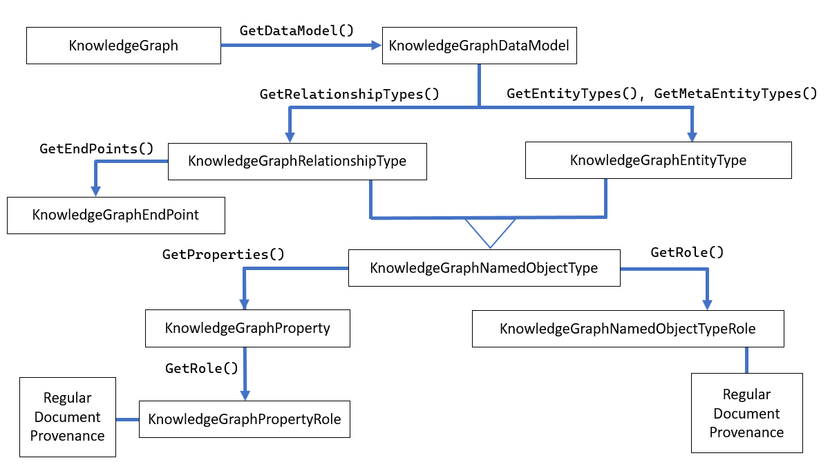

KnowledgeGraph Graph Data Model
A KnowledgeGraph datastore also provides access to the components of the graph data model (in addition to the afore mentioned gdb relational model components). Graph data model components are retrieved via openCypher graph query and (text) search results. The KnowledgeGraph datastore provides a KnowledgeGraphDataModel that can be traversed for the metadata that describes the individual knowledge graph "graph" entity and relationship types within the graph data model as well as their provenance (if any). The graph data model is detailed in the following section.
KnowledgeGraph Graph Data Model Types
The knowledge graph data model defines the types of entities and relationships that exist in the knowledge graph and their properties. Entities typically represent people, places, and things, and relationships define how the entities are associated or "connected". Entities and relationships can be spatial or non-spatial. Their properties define/describe their characteristics. A special type of entity, called a Document can be added to any ArcGIS knowledge graph to provide additional context for an entity or a relationship (in which it participates). Documents can be pictures, presentations, text or Adobe Acrobat PDF files, website links, and so on. Knowledge graph can also contain provenance. Provenance can be added to a knowledge graph to describe entity and relationship "origins" or "lineage". Provenance can describe which organizations, people, sensors, etc. may have been involved with an associated entity or relationship between entities (i.e. provenance is a "chain of custody" of sorts). Provenance is only ever stored as entities "itself".
The different types of entities present within a knowledge graph are represented by entity types. An entity type defines a homogeneous collection of entities with a common set of properties and a spatial feature type (if the given entity type is spatially enabled). A relationship type performs a similar role for relationships. Each relationship type defines a homogenous collection of relationships that can exist between two entity types, with a common set of properties and a spatial feature type (if the given relationship type is spatially enabled). A property, similar to a GDB field, has a name and value type. Properties each have a role, identified by the public KnowledgeGraphPropertyRole GetRole() method. KnowledgeGraphPropertyRole can be: a "regular" role meaning the property is an attribute or "characteristic" of an entity or relationship; the role can be a document property role (self-explanatory); or a role indicating the property is associated with provenance.
The KnowledgeGraphDataModel and primary associated classes (and enums) are diagrammed and described below:
kg_data_model
  • KnowledgeGraphDataModel represents the data model for the knowledge graph, including but not limited to entity and relationship types, spatial reference, and information about generation of unique identifiers. Access via a knowledgeGraph.GetDataModel() method call.
  • KnowledgeGraphNamedObjectType is the abstract base class for all entity and relationship types. Named object types contain metadata about the entity and relationship types in the knowledge graph including their role and properties.
  • KnowledgeGraphEntityType derives from KnowledgeGraphNamedObjectType. There is one KnowledgeGraphEntityType per individual entity type (or "category") in the graph. All entities stored in the knowledge graph must belong to a KnowledgeGraphEntityType. Entity instances will each have a type name value that matches the entity type name of which they are a part*
  • KnowledgeGraphRelationshipType derives from KnowledgeGraphNamedObjectType. There is one KnowledgeGraphRelationshipType per individual relationship "type" in the graph. All relationships stored in the knowledge graph must belong to a KnowledgeGraphRelationshipType. Relationship instances will each have a type name value that matches the relate type name of which they are a part. Relationship types also store a collection of end points represented as a KnowledgeGraphEndPoint. An end point stores the type names of the origin and destination entity types that participate in the relationship.
  • KnowledgeGraphProperty describes a property or "attribute" of an entity or a relationship. Properties are stored in the knowledge graph as key/value pairs (similar to a .NET dictionary) where the key is a unique (string) name within the set of properties for the given type. Property descriptions are retrieved off either an entity or relationship type (via the abstract base class KnowledgeGraphNamedObjectType "GetProperties()" method). The key of a given property value within an entity or relationship will match the name of its corresponding KnowledgeGraphProperty "type" (retrieved from the relevant KnowledgeGraphEntityType or KnowledgeGraphRelationshipType). Properties also have a role, identified by the KnowledgeGraphPropertyRole enum accessed via kg_prop.GetRole(). The role can be Regular, Document, or Provenance.
  • KnowledgeGraphEndPoint is associated with KnowledgeGraphRelationshipType. KnowledgeGraphRelationshipTypes have a collection of end points from which the entity type names for the origin and destination entity types participating in a given relationship can be retrieved.
*Knowledge graphs can contain two special "entity" types:
  • An entity type with the role KnowledgeGraphNamedObjectTypeRole.Document. There can only be one document entity type per knowledge graph - meaning all documents stored in a knowledge graph will be entities of that same entity type. The name of the document entity type is the name of "the" KnowledgeGraphEntityType with the document role. There is always a Document entity type defined in a knowledge graph unless it uses a NoSQL data store with user-managed data in Neo4j.
  • An entity type with the role KnowledgeGraphNamedObjectTypeRole.Provenance. The provenance type is stored in the knowledge graph meta entity type collection which is accessed via kg_dm.GetMetaEntityTypes() (note the "meta" in the method name) and not via kg_dm.GetEntityTypes(). Provenance is the only entity type that is currently stored in the knowledge graph meta entity type collection. Provenance represents origin and/or chain of custody information related to graph entities and relationships. Unlike Documents, the ability to capture provenance within a knowledge graph is not enabled by default.
Additional knowledge graph data model descriptions can be found in the Essential ArcGIS Knowledge vocabulary. The following examples show how to get the names of the Document and Provenance entity types, if present:

#region KG Utilities
protected string GetDocumentEntityTypeName(KnowledgeGraphDataModel kg_dm)  {
   var entity_types = kg_dm.GetEntityTypes();
   foreach (var entity_type in entity_types){
     if entity_type.Value.GetRole() == KnowledgeGraphNamedObjectTypeRole.Document)
        return entity_type.Value.GetName();
   return "";//prob a Neo4j user managed KG
 protected string GetProvenanceEntityTypeName(KnowledgeGraphDataModel kg_dm) {
   var entity_types = kg_dm.GetMetaEntityTypes();
   foreach (var entity_type in entity_types) {
      if (entity_type.Value.GetRole() == KnowledgeGraphNamedObjectTypeRole.Provenance)
   return "";//Not all knowledge graphs have Provenance
 protected bool SupportsProvenance(KnowledgeGraph kg) {
   //if there is a provenance entity type then the KnowledgeGraph
   //supports provenance
   return !string.IsNullOrEmpty(GetProvenanceEntityTypeName(kg.GetDataModel()));
 protected bool GetEntityIsProvenance(KnowledgeGraphEntityValue entity,
                                               string provenanceName = "") {
   if (string.IsNullOrEmpty(provenanceName))
      return false;
   return entity.GetTypeName() == provenanceName;
#endregion KG Utilities

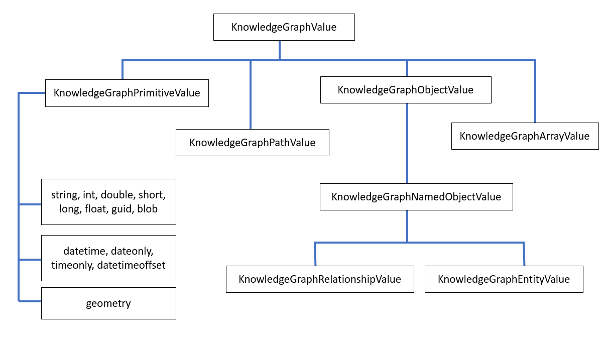

 private void ProcessGraphValue(
   int level, KnowledgeGraphValue kg_val, string prefix = "") {
   var spaces = new string(' ', level);
   var indent = $"{spaces}{prefix}";
   switch (kg_val) {
      case KnowledgeGraphPrimitiveValue kg_prim:
         //We should not get a KG Primitive Value from a Query or Search
         System.Diagnostics.Debug.WriteLine($"{indent} Primitive:");
         var val = kg_prim.GetValue();
         ProcessKnowledgeGraphRowValue(level + 1, val, " ");//Recurse
         return;
      case KnowledgeGraphArrayValue kg_array:
         System.Diagnostics.Debug.WriteLine($"{indent} Array:");
         var count = (int)kg_array.GetSize();
         for (int i = 0; i < count; i++) {
            var array_val = kg_array[(ulong)i];
            ProcessKnowledgeGraphRowValue(level + 1, array_val, $"[{i}] = ");//Recurse
         System.Diagnostics.Debug.WriteLine("");
         return;
      case KnowledgeGraphPathValue kg_path:
         System.Diagnostics.Debug.WriteLine($"{indent} Path:");
         //Entities:
         var entity_count = (long)kg_path.GetEntityCount();
         System.Diagnostics.Debug.WriteLine($"{indent} Entities - count: {entity_count}:");
         for (long i = 0; i < entity_count; i++) {
            ProcessGraphObjectValue(
                  level + 2, kg_path.GetEntity((ulong)i), $" e[{i}]:");//Recurse
         //Relationships
         var relate_count = (long)kg_path.GetRelationshipCount();
         System.Diagnostics.Debug.WriteLine($"\r\n{indent} Relationships - count: {relate_count}:");
         for (long i = 0; i < relate_count; i++)
                  level + 2, kg_path.GetRelationship((ulong)i), $" r[{i}]:");//Recurse
         return;
      case KnowledgeGraphObjectValue kg_object:
         //Anonymous
         ProcessGraphObjectValue(level, kg_object, " object:");//Recurse
         return;
      default:
         //Should never get here
         var type_string = kg_val.GetType().ToString();
         System.Diagnostics.Debug.WriteLine($"{indent} Unknown: '{type_string}'");
         return;

 private void ProcessKnowledgeGraphRowValue(
   int level, object value, string prefix = ""){
   var spaces = new string(' ', level + 1);
   if (null == value) {
       System.Diagnostics.Debug.WriteLine($"{indent} null");
       return;
   switch (value) {
      //Graph values
      case KnowledgeGraphValue kg_val:
         var kg_type = kg_val.KnowledgeGraphValueType.ToString();
         System.Diagnostics.Debug.WriteLine($"{indent} KnowledgeGraphValue: '{kg_type}'");
         ProcessGraphValue(level + 1, kg_val, " ");//Recurse
         return;
      //Primitives
      case System.DBNull dbn:
         System.Diagnostics.Debug.WriteLine($"{indent} DBNull.Value");
         return;
      case string str:
         System.Diagnostics.Debug.WriteLine($"{indent} '{str}' (string)");
         return;
      case long l_val:
         System.Diagnostics.Debug.WriteLine($"{indent} {l_val} (long)");
         return;
      case int i_val:
         System.Diagnostics.Debug.WriteLine($"{indent} {i_val} (int)");
         return;
      case short s_val:
         System.Diagnostics.Debug.WriteLine($"{indent} {s_val} (short)");
         return;
      case double d_val:
         System.Diagnostics.Debug.WriteLine($"{indent} {d_val} (double)");
         return;
      case float f_val:
         System.Diagnostics.Debug.WriteLine($"{indent} {f_val} (float)");
         return;
      case DateTime dt_val:
         System.Diagnostics.Debug.WriteLine($"{indent} {dt_val} (DateTime)");
         return;
      case DateOnly dt_only_val:
         System.Diagnostics.Debug.WriteLine($"{indent} {dt_only_val} (DateOnly)");
         return;
      case TimeOnly tm_only_val:
         System.Diagnostics.Debug.WriteLine($"{indent} {tm_only_val} (TimeOnly)");
         return;
      case DateTimeOffset dt_tm_offset_val:
         System.Diagnostics.Debug.WriteLine($"{indent} {dt_tm_offset_val} (DateTimeOffset)");
         return;
      case System.Guid guid_val:
         var guid_string = guid_val.ToString("B");
         System.Diagnostics.Debug.WriteLine($"{indent} '{guid_string}' (Guid)");
         return;
      case Geometry geom_val:
         var geom_type = geom_val.GeometryType.ToString();
         var is_empty = geom_val.IsEmpty;
         var wkid = geom_val.SpatialReference?.Wkid ?? 0;
            $"{indent} geometry: {geom_type}, empty: {is_empty}, sr_wkid {wkid} (shape)");
         return;
      default:
         //Blob?, others?
         var type_str = value.GetType().ToString();
         System.Diagnostics.Debug.WriteLine($"{indent} Primitive: {type_str}");
         return;
#endregion Read KG Values

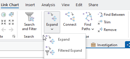

Expand and Filtered Expand
First, at least one entity must be selected to expand from. Second, to mimic the built-in Expand (or Filtered Expand) operation limit the maximum length of all discovered paths to be 1. Direction is not important so that can stay as KGTraversalDirectionType.Any. Entities can be either origin or destination on discovered shortest paths so we leave the entity usage as FilteredFindPathsEntityUsage.AnyOriginAnyDestination. As we want to consider all entity types as possible destinations we configure the ffp_config.DestinationEntities using all the entity types pulled from the data model rather than from the link chart as the link chart content may currently only be including a subset of the available entity types.

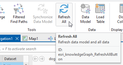

kg_data_model_out_of_sync
The message alerts the user that the UI is aware that the underlying datamodel has changed but not what the change is/was and needs to be refreshed. To manually refresh the UI at any time, users will execute the Refresh All button on the investigation tab.
kg_refresh_all_btn
From within core host applications, sb.Build() will always be used as application context and UI refresh considerations are moot. For code snippets illustrating various common schema builder operations (create, modify, and delete), consult the ProSnippets KnowledgeGraph Schema Edits section.
