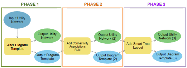

  • Phase 1—Create a template and configure its elementary properties.
  • Phase 2—Add rules that define the final diagram content.

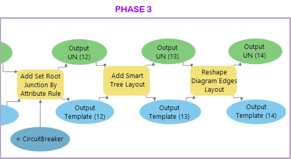

  • Phase 3—Add the set of diagram layouts that generate the presentation (spacing, visibility, and so on) of a diagram.
Three phases of the diagram template's rule and layout definitions geoprocessing model

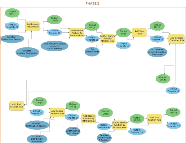

Example of adding diagram rules to a diagram template
The steps below are an example of adding diagram rules to a diagram template. The purpose of this sample is to chain the Add <XXX> Rule or Add <XXX> By Attribute Rule tool in a diagram template to allow the generation of diagrams from a subnetwork trace that starts from the circuit breakers among the input features. The resulting trace will then be simplified by collapsing most of the containers and reducing junctions and devices, except circuit breakers and switches. To ensure the diagrams based on this template will strictly reflect the expected subnetwork traces, some Remove Feature rules will be configured at the beginning of diagram generation to discard all unexpected input features.
Prerequisite:
Create an elementary diagram template geoprocessing model as described in Phase 1—Create a template and configure its elementary properties before applying the next steps.
  1. Open the diagram template geoprocessing model you created in the previous section.
  2. Configure diagram rules to remove any unexpected features that may have been selected as input. In this example, Remove Feature rules are set up to discard all input features, except structure boundaries and circuit breaker distribution devices:
    1. In the Configuration toolset, drag the Add Remove Feature Rule tool to the model view.
    2. Connect the output variables of the Alter Diagram Template tool to the Add Remove Feature Rule tool as follows:
      • Click the output network variable of the Alter Diagram Template tool while you move the pointer to the Add Remove Feature Rule tool. Click Input Network.
      • Click the output template variable of the Alter Diagram Template tool while you move the pointer to the Add Remove Feature Rule tool. Click Input Diagram Template.
    3. Double-click the Add Remove Feature Rule tool in the model and set the rule parameters to remove all features except electric distribution devices and structure boundaries as follows:
      • Source Type—Select Both junctions and edges.
      • Rule Process—Select Exclude source classes.
      • Network Sources—Select ElectricDistributionDevice, and select Structure Boundary.
    4. Click OK.
    5. In the Configuration toolset, drag the Add Remove Feature By Attribute Rule tool to the model view.
    6. Repeat steps 2.b above to connect the output variables of the Add Remove Feature Rule tool as inputs for the Add Remove Feature By Attribute Rule tool.
    7. Double-click the Add Remove Feature By Attribute Rule tool in the model and set the rule parameters to remove any electric distribution devices except circuit breakers:
      • Network Source To Remove—Select ElectricDistributionDevice.
      • Expression—Click New Expression. Then select Asset group for Field, and click Is not equal to as the expression operator. Check 4 - CircuitBreaker for Values, and click Update.
    8. Click OK.
  3. Set the starting points among the features that will remain. In this example, a Set Starting Point rule is configured to set any circuit breaker with a terminal ID of 3/ Load as a starting point:
    1. From the Configuration toolset, drag the Add Set Starting Point By Attribute Rule tool to the Model tab.
    2. Connect the output variables from Add Remove Feature By Attribute Rule as input for Add Set Starting Point By Attribute Rule.
    3. Double-click the Add Set Starting Point By Attribute Rule tool in the model and set the rule parameters:
      • Network Source—Select ElectricDistributionDevice.
      • Expression—Click New Expression. Then select Asset group for Field, and click Is equal to as the expression operator. Check 4 - CircuitBreaker for Values, and click Update.
      • Junction Terminal(s)—Check 3/Load.
    4. Click OK.
  4. Add a Trace rule to trace medium-voltage distribution subnetworks:
    1. Double-click the Add Trace Rule tool in the model and set up a Trace rule to trace subnetworks as follows:
      • Trace Type—Select SUBNETWORK.
      • Domain Network—Select ElectricDistribution.
      • Tier—Select Medium Voltage.
    2. Click OK.
  5. Collapse containers. In this example, the Collapse Containers rule is configured to collapse all containers except structure boundaries:
    1. In the Configuration toolset, drag the Add Collapse Container Rule tool to the model view.
    2. Connect the output variables from Add Trace Rule as input for Add Collapse Container Rule.
    3. Double-click the Add Collapse Container Rule tool in the model and set the rule parameters:
      • Container Type—Select Both junctions and edges.
      • Container Sources—Select StructureBoundary.
      • Aggregate reconnected edges—Leave the box checked.
    4. Click OK.
  6. Loop on a sequence of reduction rules to reduce all junctions that have 0, 1, or 2 other junctions, except distribution devices and assemblies; reduce all distribution assemblies except the switch gears and switch banks; and reduce all distribution devices except the circuit breakers and switches:
    1. In the Configuration toolset, drag the Add Start Iteration Rule tool to the model view.
    2. Connect the output variables from Add Collapse Container Rule as input for Add Start Iteration Rule.
    3. In the Configuration toolset, drag the Add Reduce Junction Rule tool to the model view.
    4. Connect the output variables from Add Start Iteration Rule as input for Add Reduce Junction Rule.
    5. Double-click the Add Reduce Junction Rule tool in the model and set the rule parameters:
      • Junction Sources—Select ElectricDistributionDevice and select ElectricDistributionAssembly.
      • Connectivity constraints—Expand this section:
        • Reduce Junctions With—Select Maximum two connected junctions.
        • Reduce if unconnected—Check the box.
        • Reduce if connected to a single junction—Check the box.
        • Reduce if connected to 2 different junctions—Leave the box checked.
    6. Click OK.
    7. In the Configuration toolset, drag the Add Reduce Junction By Attribute Rule tool to the model view.
    8. Connect the output variables from Add Reduce Junction Rule as input for Add Reduce Junction By Attribute Rule.
    9. Double-click the Add Reduce Junction By Attribute Rule tool in the model and set the rule parameters:
      • Junction Source To Reduce—Select ElectricDistributionAssembly.
      • Expression—Click New Expression. Then select Asset group for Field and click Does not include the value(s) as the expression operator. Check 8 - Switch bank and 9 - Switchgear for Values and click Update.
        • Reduce if unconnected—Check this box.
        • Reduce if connected to a single junction—Check this box.
        • Reduce if connected to 2 different junctions—Leave this box checked.
    10. Click OK.
    11. In the Configuration toolset, drag the Add Reduce Junction By Attribute Rule tool to the model view.
    12. Connect the output variables from the first Add Reduce Junction By Attribute Rule as input for the second Add Reduce Junction By Attribute Rule.
    13. Double-click the second Add Reduce Junction By Attribute Rule tool in the model and set the rule parameters:
      • Junction Source To Reduce—Select ElectricDistributionDevice.
      • Expression—Click New Expression, select Asset group for Field, and click Does not include the value(s) as the expression operator. Check 4 - Circuit Breaker and 15 - Switch for Values and click Update.
    14. Click OK.
    15. In the Configuration toolset, drag the Add Stop Iteration Rule tool to the model view.
    16. Connect the output variables from Add Reduce Junction By Attribute Rule as input for Add Stop Iteration Rule.
The second phase of your diagram template geoprocessing model should look similar to the following:
Phase 2 example diagram template's rule and layout definitions geoprocessing model
  2. In the Configuration toolset, drag the Add Set Root Junction By Attribute Rule tool to the model view.
  3. Use steps 10a and 10b from the Phase 1 workflow to connect output variables from Add Stop Iteration Rule as input for Add Set Root Junction By Attribute Rule.
  4. Double-click the Add Set Root Junction By Attribute Rule tool in the model and set up the Set Root Junction rule so it flags each circuit breaker as a junction root:
    1. Select DistributionDevice from the first drop-down list under Junction Source To Select.
    2. Click New Expression.
    3. Select Asset group for Field, click is Equal to as the expression operator, and check 4 - CircuitBreaker for Values. Click Update.
    4. Click OK.
  5. In the Configuration toolset, drag the Add Smart Tree Layout tool to the model view.
  6. Connect output variables from Add Set Root Junction By Attribute Rule as input for Add Smart Tree Layout.
  7. Double-click the Add Smart Tree Layout tool in the model and set up the layout algorithm so it arranges the tree branches from the top to the bottom:
    1. Leave the Active box checked so the algorithm activates during diagram generation.
    2. Select From top to bottom from the Tree Direction drop-down list.
    3. Click OK.
  8. In the Configuration toolset, drag the Add Reshape Diagram Edges Layout tool to the Model tab.
  9. Connect output variables from Add Smart Tree Layout as input for Add Reshape Diagram Edges Layout.
  10. Double-click the Add Reshape Diagram Edges Layout tool in the model and set up the layout algorithm so it separates edges that may be overlapping in the diagram:
    2. Select Separate overlapping edges from the Reshape Operation drop-down list.
    3. Click OK.
The third phase of your diagram template geoprocessing model should look similar to the following:
Phase 3 example diagram template's rule and layout definitions geoprocessing model
