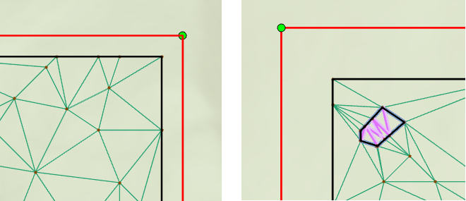

  • Super nodes - When a TIN is initially constructed it contains four generated points that reside far outside the declared data extent. These are connected into two triangles and this initial triangulation is what the data is added to. The four generated points are referred to as super nodes.
  • Super node extent - The super node extent is the minimum bounding rectangle that surrounds the 4 super nodes.
  • “inside”, “outside” - TIN elements can be classified as “inside” or “outside” the TIN. When TINs are initially built the only elements that are "outside" are the four super nodes and their incident edges and triangles. If clip or erase polygons are added to a TIN, they further modify what is considered to be "inside" or "outside”.
  • Data area - This is the area that defines the boundary between the “inside” and “outside” elements. It is also known as the interpolation zone. When TIN’s are initially built from points the data area is a convex hull that surrounds all the user entered data. If clip or erase polygons exist or are added to the TIN, then the data area will be modified and defined as a multipart polygon with the clipped or erased elements being excluded.
Super nodes and their associated edges and triangles are not typically displayed as they are outside the TIN's data area.
In the pictures below, the super nodes have been added to the overlay and are displayed as bright green circles, the super node extent is the area denoted by the red border and the data area is denoted by the black border. In the second image you can see that the TIN's data area has a hole; an area has been cut from the TIN. The purple lines inside the hole denote "outside" edges and triangles whereas the other elements are "inside".

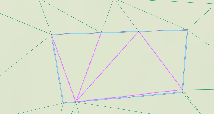

Here are some examples which illustrate the DataElementsOnly property. Consider the following where a region has been cut from the TIN introducing an "outside" area. The purple colored edges are "outside", the blue colored edges are "hard" edges; that is they represent a breakline.
TIN searching
Using the following code snippet the following counts are obtained.
  • nodeCountInside = 8; nodeCountAll = 8
  • edgeCountInside = 26; edgeCountAll = 31
  • triCountInside = 18; triCountAll = 24
