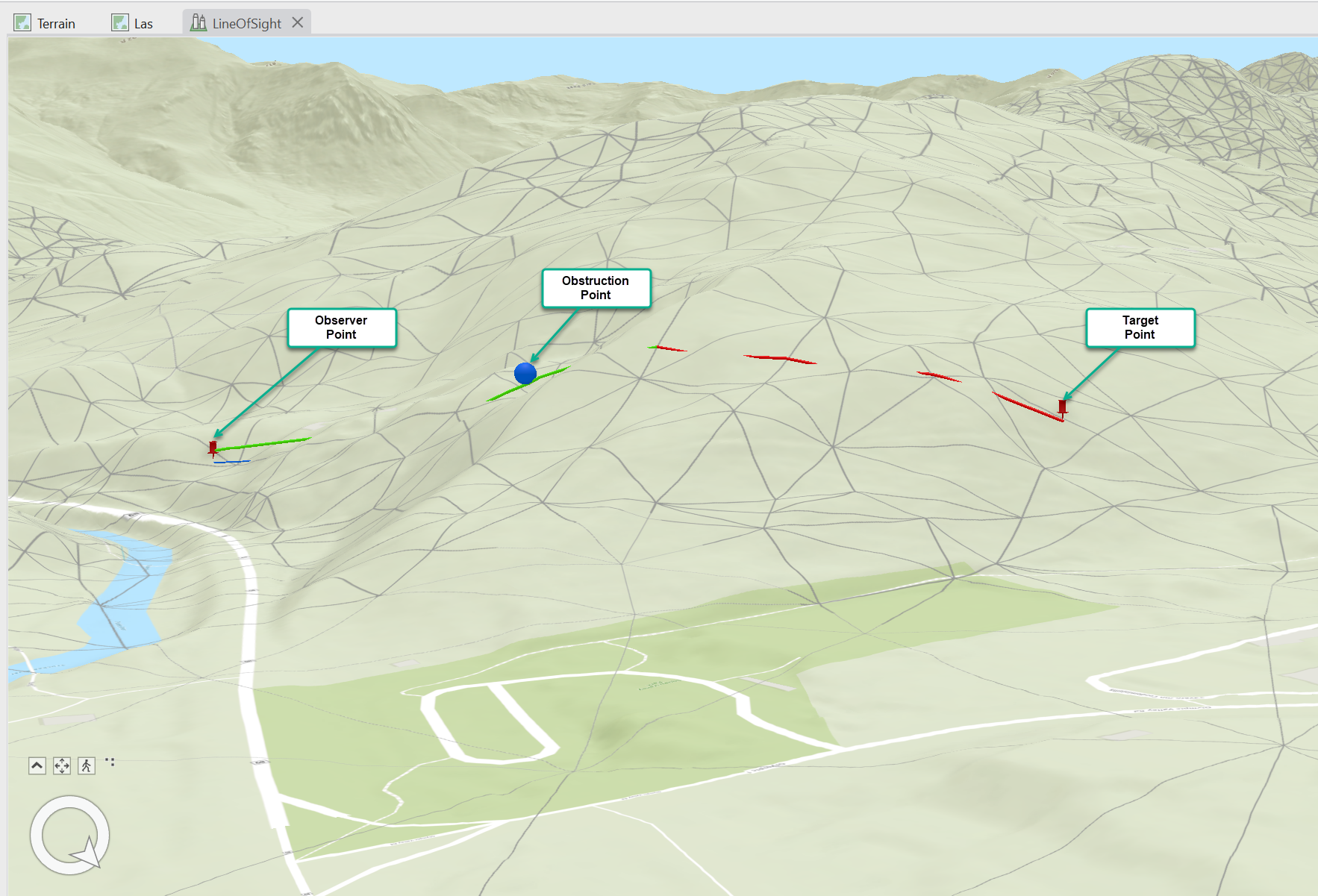

Line of Sight
Line of sight is used to determine if a target is visible from a given observer's viewpoint on or above a surface. And to determine which sections of the surface's profile between the observer and target are visible and not visible from the observer. Use the GetLineOfSight method on the TinLayer to perform this type of 3D analysis.
Note, that this method is not supported with TerrainLayer or LasDatasetLayer and will throw an InvalidOperationException if called with these layer types. The method also requires the use of a 3D Analyst license and a LicenseException exception will be thrown if one is not available.
Create a LineOfSightParams instance to specify the ObserverPoint and TargetPoint. If you use a MapTool to generate the observer and target points via a mouse click, be aware that you can, and should, control which surface is used for determining the XYZ location where you clicked. At the bottom of the Contents pane, there is a category named Elevation Surfaces, within which there is a category named Ground. The first (uppermost) item in the Ground category is the surface that will be used to determine the Z value on mouse click. There are different ways of adding a surface to this category; refer to https://doc.esri.com/en/arcgis-pro/3.7/help/mapping/layer-properties/elevation-surfaces.html for details.
During the calculation the elevation of the observer point (let's call it "observerZ") is derived as follows: if you provide a Z-aware (3D) observer point, observerZ will be set to its Z value; if you provide a 2D observer point, then observerZ will be set to the Z value of the surface at the XY of the observer point. The target point's Z value is calculated in the same manner. If you wish to specify height offsets for the points, use the ObserverHeightOffset or TargetHeightOffset properties. These values are added to the Z values of the observer and target points respectively. It is recommended that you provide a positive ObserverHeightOffset so that the observerZ is above the surface rather than being embedded on it.
You can also choose to have the calculation make adjustments for curvature and refraction with the ApplyCurvature or ApplyRefraction properties. Note that for the two flags to be valid, the spatial reference of the surface must be in a projected coordinate system and have Z coordinate units defined. Use RefractionFactor to set a custom refraction factor if you wish to use something other than the default refraction factor of 0.13.
It is important to call CanGetLineOfSight prior to GetLineOfSight to perform some checking on the parameters to ensure a possible result can be found and that your chosen parameters are compatible with the underlying surface. Note a return of "true" from CanGetLineOfSight does not preclude GetLineOfSight from still throwing an exception due to other possible calculation errors. Callers should always use appropriate exception handling techniques to avoid failures.
Internally, GetLineOfSight generates an imaginary straight 3D line (called "the sight line") from the observer point (at observerZ) to the target point (at targetZ). It then interpolates (drapes) this line onto the surface, creating an imaginary profile line. The typical results consist of a "visible" line (possibly a multipart) representing the portion of the profile line which is visible from the observer point (at observerZ), and an "invisible" line (also, possibly a multipart) representing the portion of the profile line which is not visible from the observer point (at observerZ). If the sight line intersects the surface at least once, then an obstruction point is created at the first intersection point which is closest to the observer point. The obstruction point, if created, will always lie along the profile line, but will typically not occur at the end of the first visible line part.
Results from the analysis are returned in a LineOfSightResult object. The key properties of this class are
  • IsTargetVisibleFromObserverPoint - true if the target point is visible from the observer point, otherwise false.
  • Visible Line - The visible parts of the profile line. If the profile line is totally obstructed this will be null.
  • Invisible Line - The invisible parts of the profile line. If there is no obstruction, this will be null.
  • Obstruction Point - The location of the first obstruction on the sight line. If there is no obstruction, this will be null.
You can visualize the geometry results in your map by adding them to the overlay or saving them into feature classes depending on your use case.
At ArcGISPro 3.5, an additional property was added to the LineOfSightParams object; the ObstructionsMultipatchFeatureClass property. This property allows you to specify a multipatch feature class that defines additional obstructing features to be incorporated into the Line of Sight analysis.
A complete sample that illustrates the line of sight functionality is available in the arcgis-pro-sdk-community-samples repository. Get Line Of Sight Sample. Here is a snippet showing how to execute a line of sight analysis for an observer and target point:
